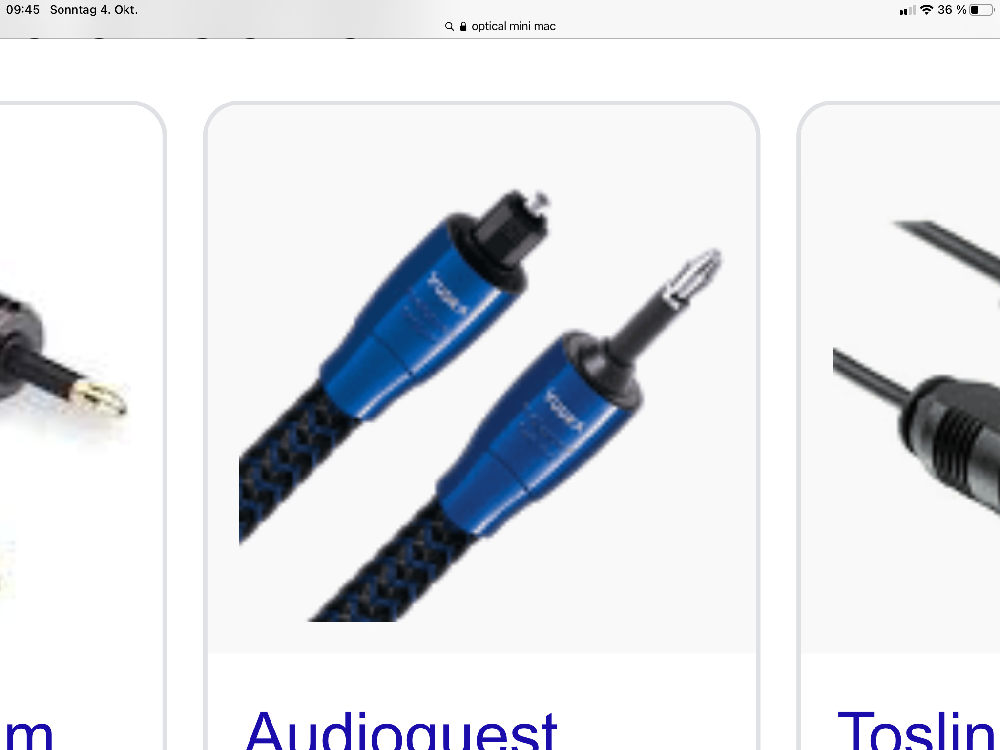

Mac mini ( my model here) has optical out— it uses same physicsl port like the headphone output, you need a special adapter

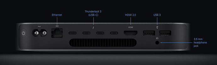

This is the latest and useful features like an optical out have been removed , would usb to the Naim’s USB or Ethernet work? I seem to remember trying this with an Apple TV and ended up with adapters and massed cabling , plugs which is what I am trying to avoid.
no it wont work by plugging it into the naims ethernet or usb.
Are you sure? The headphone is the optical out.
This feature was removed in 2018 (or around then).
If the Mac Mini is pre 2018 then as you say there is a mini toslink port included in the headphone/speaker port.
The USB input on a Unitiqute can’t be used to attach a computer.
Ethernet is not a direct point to point connection, you attach all your devices to your network and they find each other. Connect them to your router, either directly or via a switch.
