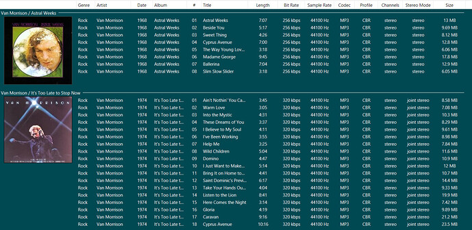

The Stereo Mode (Stereo or Joint Stereo) feature could not be the main reason why MP3 files do not play. As I wrote yesterday, both Astral Weeks (Stereo) and It’s Too Late to Stop Now (Joint Stereo) do not play; Moondance and Tupelo Honey, both in Joint Stereo Mode, play perfectly.

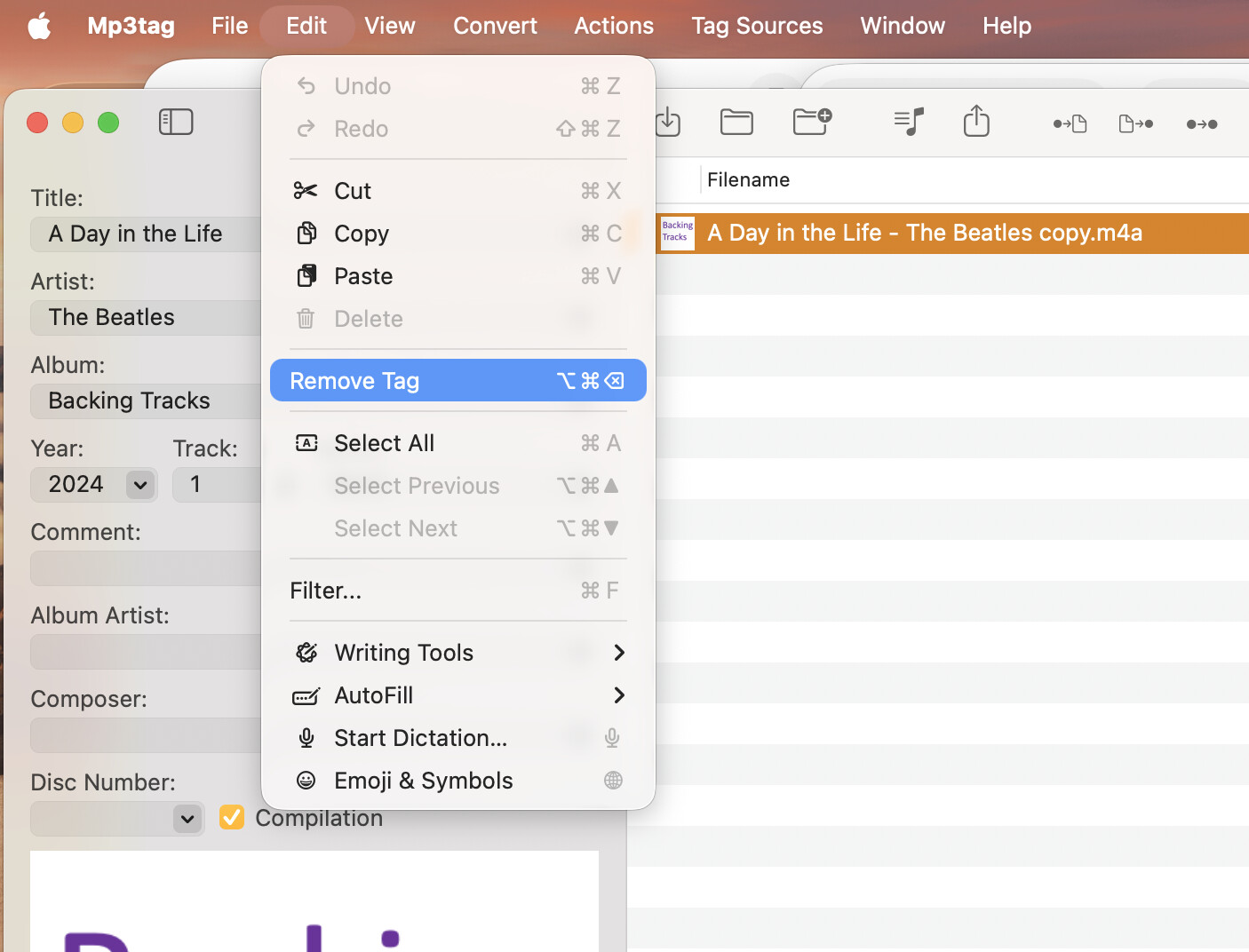

You can also delete the metadata in MP3Tag (and of course you can check the Joint Stereo issue withing MP3tag)

With Mp3Tag,
I removed the Gallery Art picture and saved the files.
I added the SAME Gallery Art picture and saved the files.
And now, they all work fine !
This gallery art picture is 215ko large.
I don’t know why and how removing / adding the same solved but it solved !
