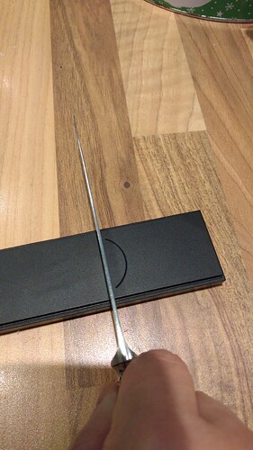

I’ve fettled the latch with a Stanley blade now by taking some wafer thin slivers off. However I’ve since found that a table knife will do the trick if you place the blade in the groove and lever the back off.
