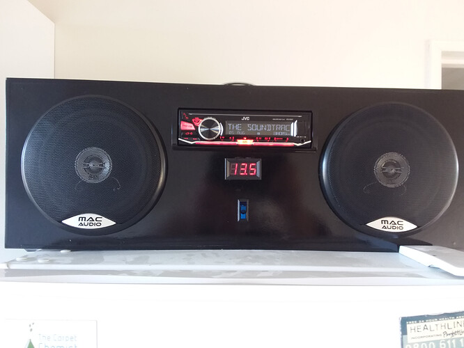

You could go diy something like this, it has a 7Ah 12 volt gel battery and charger built in, separate speakers would be better but I made it for use in a tent so didn’t want to get too crazy. I have built several versions of this sort of thing and they work well and sound surprisingly good with the battery lasting up to 12 hours at moderate volume. the best part is that it was a easy, inexpensive and fun project.
