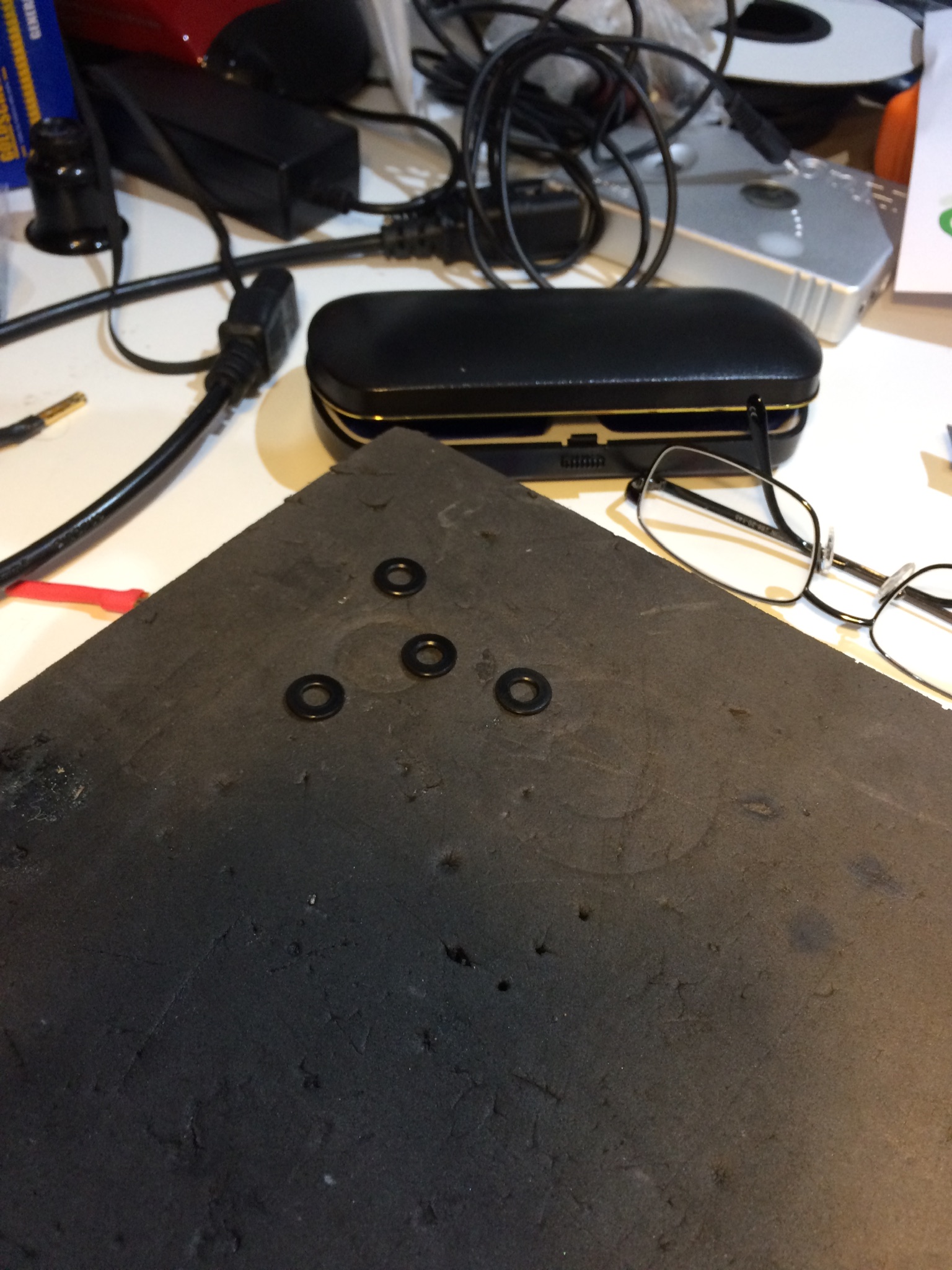

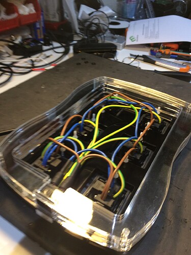

@NigelB and @anon4489532 asked about can it be done by the customer. From a HSE point of view i think musicworks would rather a dealer performed the task. There would always be one person who did the upgrade with it plugged into the mains or fiddled with the internal wiring? In the first photo you can seethe musicworks instructions on how not to electrocute yourself…they are covering themselves by getting it done as a dealer fit.

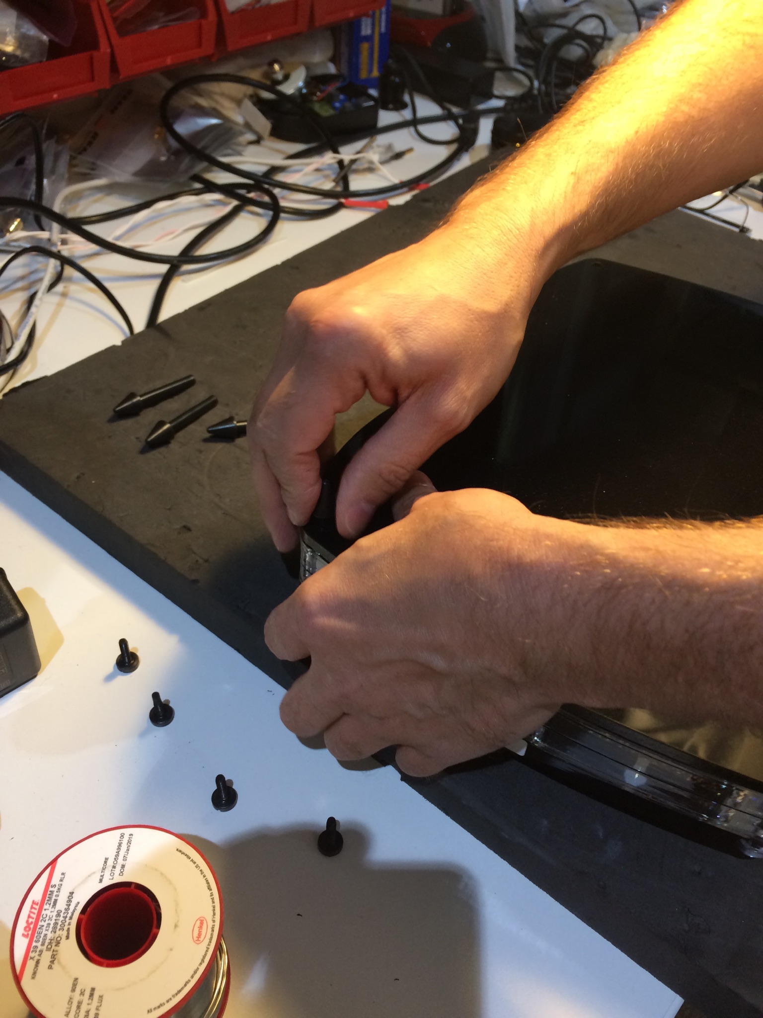

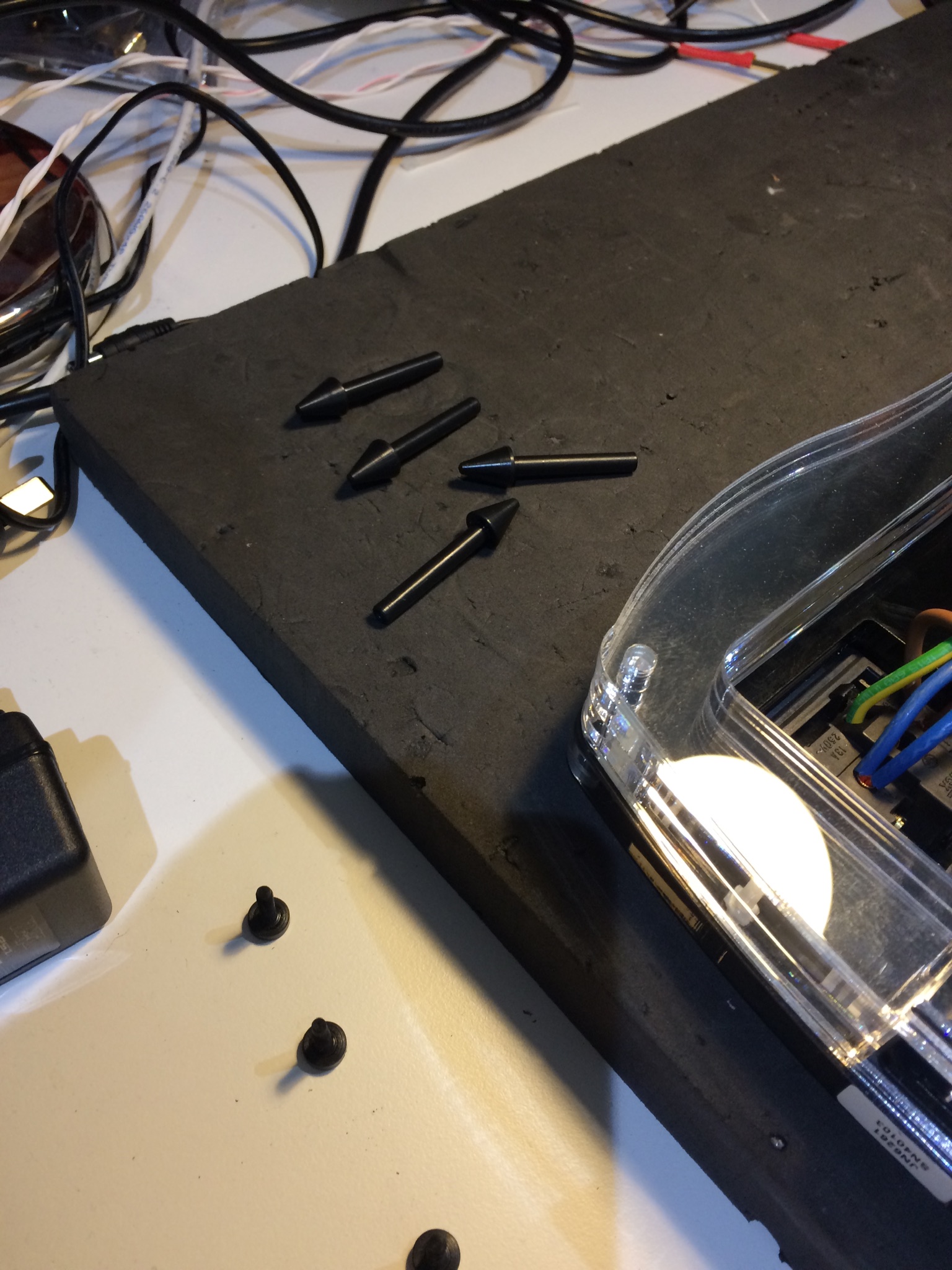

However, its real simple to do. Remove the 4 screws on the top plate and be careful not to lose the “peek” washers…they are expensive. Turn over pull out the feet, and remove the base plate and discard ( seems a shame). Remove plastic film on either side of new peek plate, position in place, slot the feet in. Turn over and use the screws and washers to fasten, just tighten and then give a small extra nip to tighten, don,t over tighten. Done.
So i think you can easily do it if you have a good dealer relationship and they trust your ability…it certainly a good upgrade imo.
Interesting, a star earthing system as expected but the live and neutral are wired to create a small ring?
:small_blue_diamond:@Gazza,…Excellent, do you know what it is for socket.?
