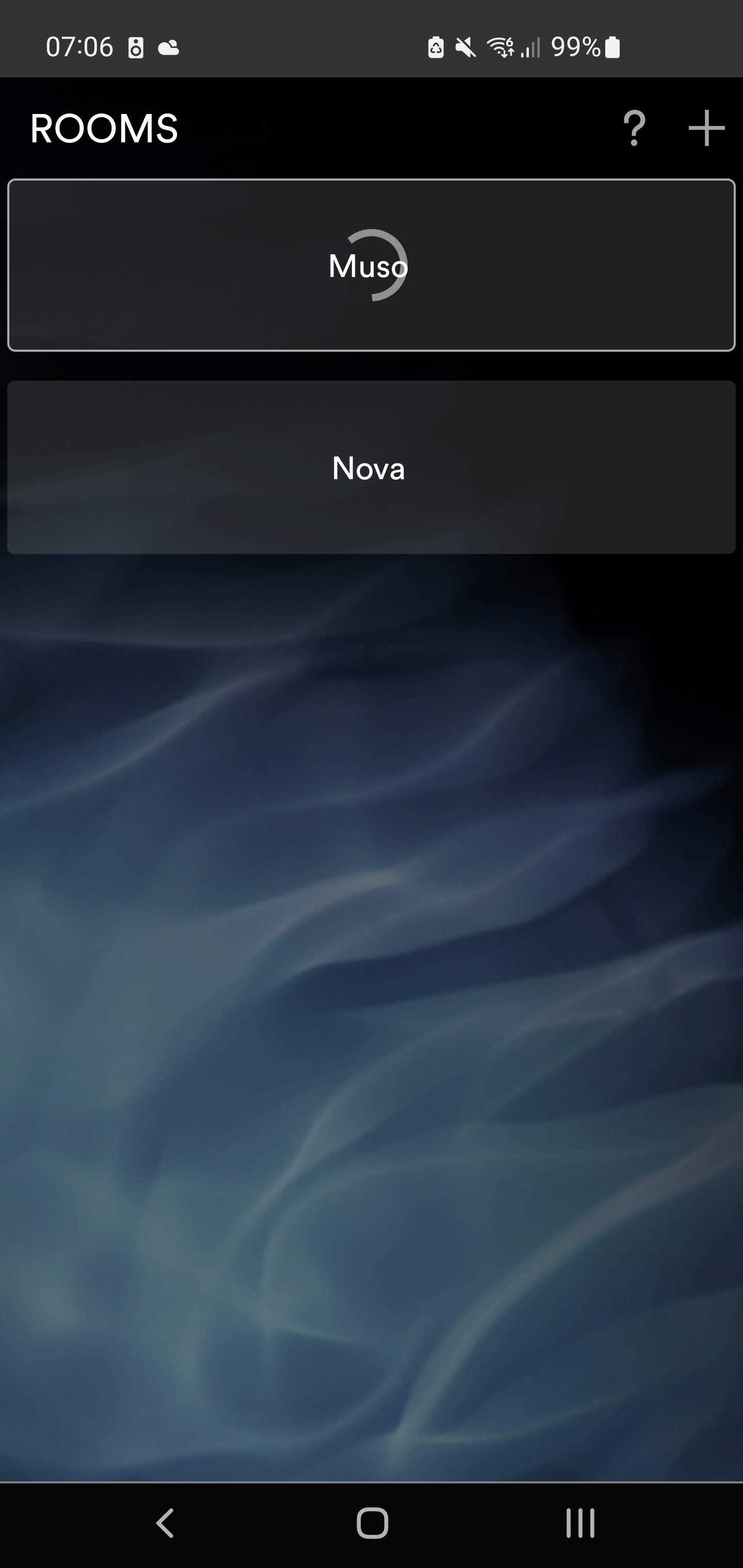

Things seemed OK at first, it would play fine, sync with the Nova when needed (with the occasional drop) but after a few days the Naim App could no longer find the Muso and it constantly searches for it without success (see screenshot sample).
The only solution is to unplug the Muso, plug it back in and re-add it to the app, but then after a few days it would do the same again! I have also tried to reboot the routers.
