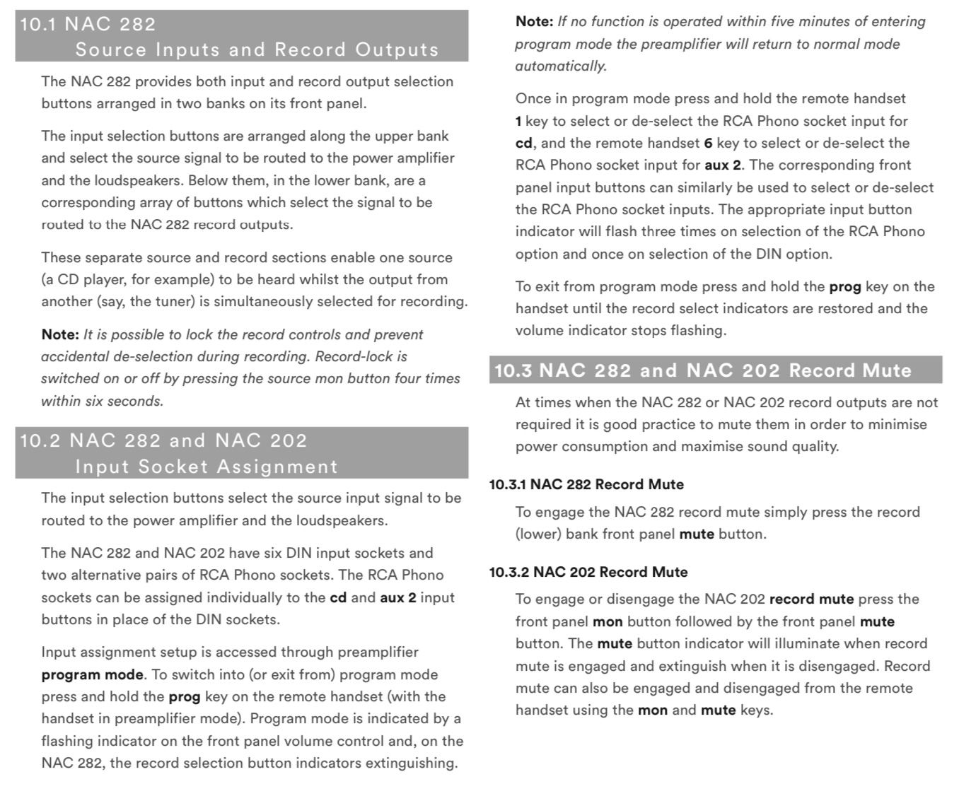

As to the inputs - the CD and Aux2 RCA sockets can be assigned to the input buttons instead of the DIN sockets - they may have been assigned by the previous owner so you may need to change that.

Yes you’ll need the remote unfortunately to reassign the inputs.
