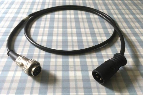

Naim DIN4 - XLR Interconnect1|600x400
Pictured above - Naim DIN4-XLR lead. Thin black-sheathed 3 core cable, DIN4 at source end, Naim Cannon XLR connector at the other end. Used for connecting a Naim pre-amp + power supply to a Naim regulated power amplifier. Versions: White band (Channel 1 + Channel 2) for use with NAP250; Green band (Channel 1) and Red band (Channel 2) for use with NAP135, NAP300, NAP500. Length 1.0m.

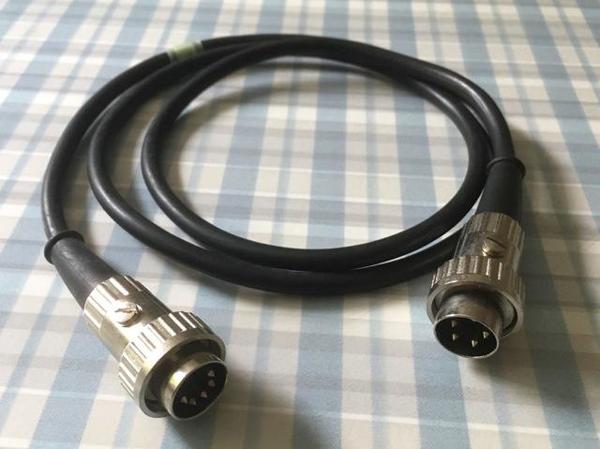

Naim SNAICs.
SNAICs carry audio signals and can also carry 24v DC power. The SNAIC 4 is included with most unregulated Naim power amplifiers. A SNAIC 5 is included with the Flatcap and Hicap power supplies.
Naim SNAIC41|600x426
Pictured above - SNAIC 4. Thick black sheathed cable with black/dark grey heat shrink ends, white banded direction marker, DIN4 connectors at each end. Can carry L+R signal and 1 x 24v DC. Used for connecting a Naim pre-amp or pre-amp + PSU to a Naim unregulated power amp. Also for connecting a Naim single-rail power supply to a single-rail pre-amp. Length 1.25m.
Naim SNAIC51|600x409
Pictured above - SNAIC 5. Thick black sheathed cable with black/dark grey heat shrink ends, green banded direction marker, DIN5 (240) connectors at each end. Can carry L+R signal and 2 x 24V DC. Used for connecting a Naim dual-rail power supply to a Naim pre-amp, phono stage, or analogue output stage of a CD3.5/5/5x/5xs CD player. Also for connecting a Naim phono stage to the powered AUX2 input of a Naim pre-amp. Other versions: SNAIC 5-4 - for connecting a Naim dual-rail power supply to an early single-rail pre-amp. Length 1.25m.

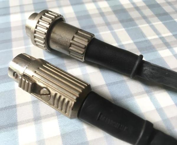

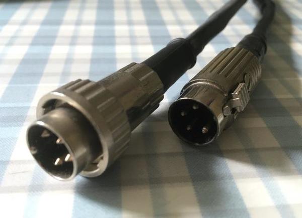

Earlier SNAICs
Earlier versions of the SNAIC4 and SNAIC5 had a grey outer sheath to the cable. The later black versions are superior in sound performance. The earliest of the grey SNAICs used latching Deltron DIN connectors instead of the later locking ring Preh DIN connectors shown above. The later Preh DIN plugs can be used with the earlier Deltron sockets by inserting with the locking ring in the fully retracted position. Note though that you cannot secure the plug to the socket so care should be taken to prevent accidental disconnection, which may result in damage to your speaker HF drive units should the system be fully powered up and speakers connected.
Naim SNAIC4 early grey1|600x425
Pictured above - SNAIC4 (early). Note the grey outer cable sheath and latching Deltron DIN plugs.
Naim SNAIC Deltron vs Preh DIN1|600x494
Naim SNAIC Deltron vs Preh DIN2|600x433
Pictured above - comparison of current Preh locking ring DIN and earlier Deltron latching DIN connectors.
