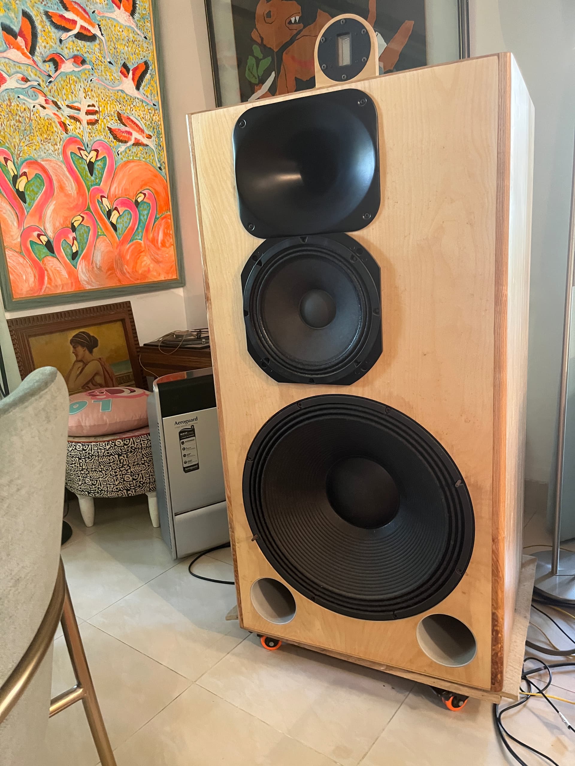

Now I’m driving these:
I know this forum is not a place where we typically compare sizes, but I’m pretty sure that at 18 inches, “mine is bigger than yours”. BTW the woofer is driven by “500W” Hypex Plates (Class D with DSP built in) and the other 3 drivers have a regular passive crossover. A peculiar beast, all DIY, built faithfully to spec. The-Loudspeaker-2
