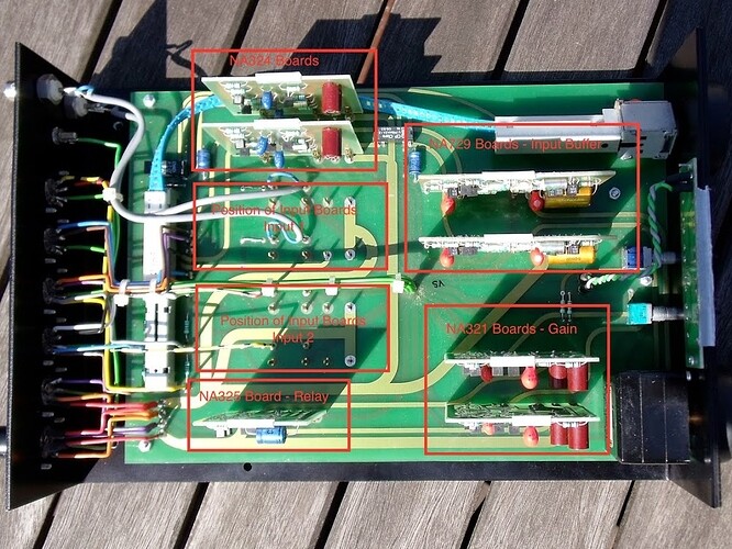

Would like to have a NAC72 (replacement of the one I sadly sold a year back) and could get one that looks like that:
There is a free spot of boards - which Ione is missing here?
found this inside the forum:
Which one is input 2?
Which input can not be used with the boards missing at this section?
Thanks a lot!
Input 2 is the 2nd input from the left as you look at the rear of the 72.
For your 72 this will be the cd input. The din inputs are line level so no boards are required.

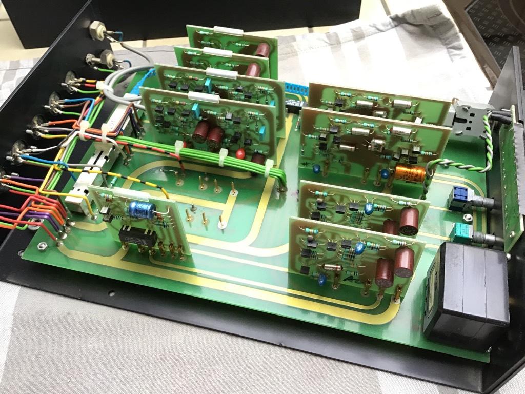

BTW, looks like it could do with service?
OK - CD input works without board? is this correct.
Why do you think it is in need of service. Looks very fine at the inside to my opinion.
Or do you think from its pure age?
Well, I’m bl**dy impressed that you can tell from the photo that the 72 needs a service, but what is it about the photo that leads you to that conclusion?
That’s what I thought a minute ago - looks fine to me the 72!
Probably down to the dark red Roederstein caps.
OK - is this a problematic part. But should not be a showstopper being it as it looks good - and has all original parts inside (imho).
Are there boards missing inside - or is this the original status with no boards on the CD Input?
I can use CD Input without board?
Buhen a board is fitted I can use ist as 2nd phono? Is this the reason for the optional boards?

I also learned that there are no missing boards.
I think this confirms my gut feeling, that I should get this nice NAC 72 :slight_smile:
From the outside it looks like new.
Confirmed from your side? :slight_smile:

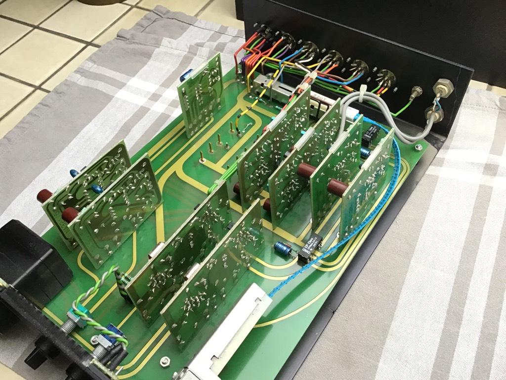

Can anyone confirm the one (pics above) too be fine.
Think I understood correctly that there is no board missing!?
No board missing there. That input could have boards fitted though but you needed to cut the links on the main board.
Tanks a lot
Correct.
