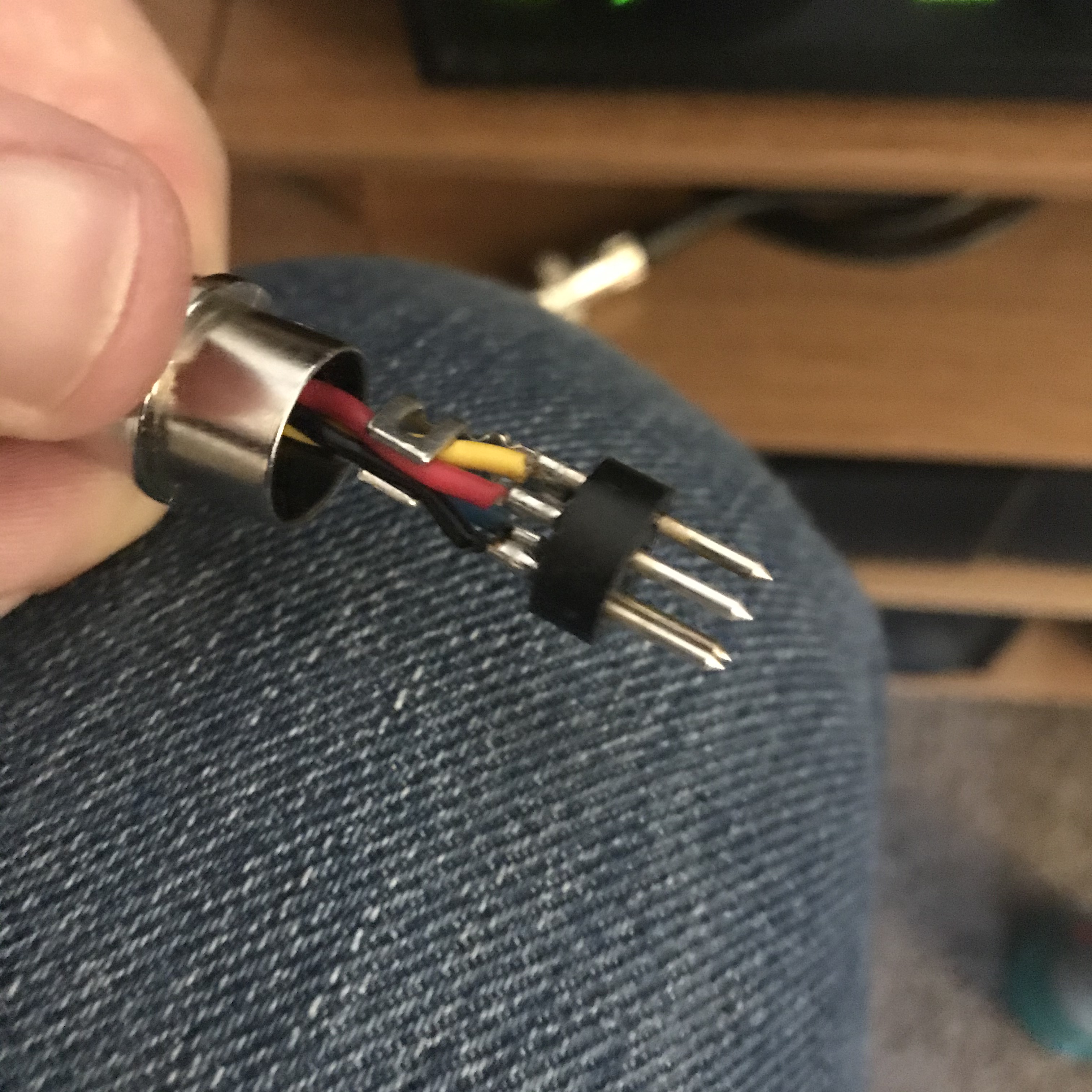

The naim snaics I don’t think are shielded. However if you have done some dressing of cables and removeed the hum then good.
Err… hum. Oh yes they are. Quite definitely… :thinking:
Most cables of this type are made with their conductors twisted together, with an overall screen.
Many years ago, I had a NAC42 - which had its Switch fail - it became noisy/crackly. The switch was replaced, by my Naim dealer.
OK. Twisted pair with shielding is good then. Only reason I thought not, was because a certain hat wearing witch makes great claims about their alternatives being shielded. Anyway, sounds like a naim snaic is too. :+1:
Above is a picture of the ‘innards’ of a SNAIC-4 (it was quite difficult to get even this far…).
Looking down inside the DIN shroud, I can see a 5th conductor, chopped off (so I guess SNAIC-5’s and SNAIC-4’s are both made of the same 5-way cable) - and I can see a Screen.
What I cannot say is if the Screen is terminated - it is not at the end shown above.
So is it ‘screened’ or not…? It looks like the Screen istself isn’t used - but the cable is of 5 way twisted construction, so is effectively ‘self screening’ - any Common Mode efects will be cancelled out.
No SNAIC’s were harmed in the process of producing this message… :laughing:
That’s above and beyond for a Thursday evening! Any screening should only be earthed at one end. Typically that end is away from the source. Hence the direction of the cable fitment is important. But as you say they are twisted pairs as well.
But as its a snaic, it will have power and signal close together. Not normally ideal.
Yes, but… the power is closely regulated DC.
