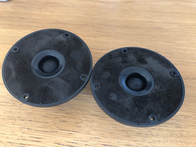

Of course, the tweeters are another matter and over time they get quite badly degraded. This is what mine looked like when Jason replaced them:

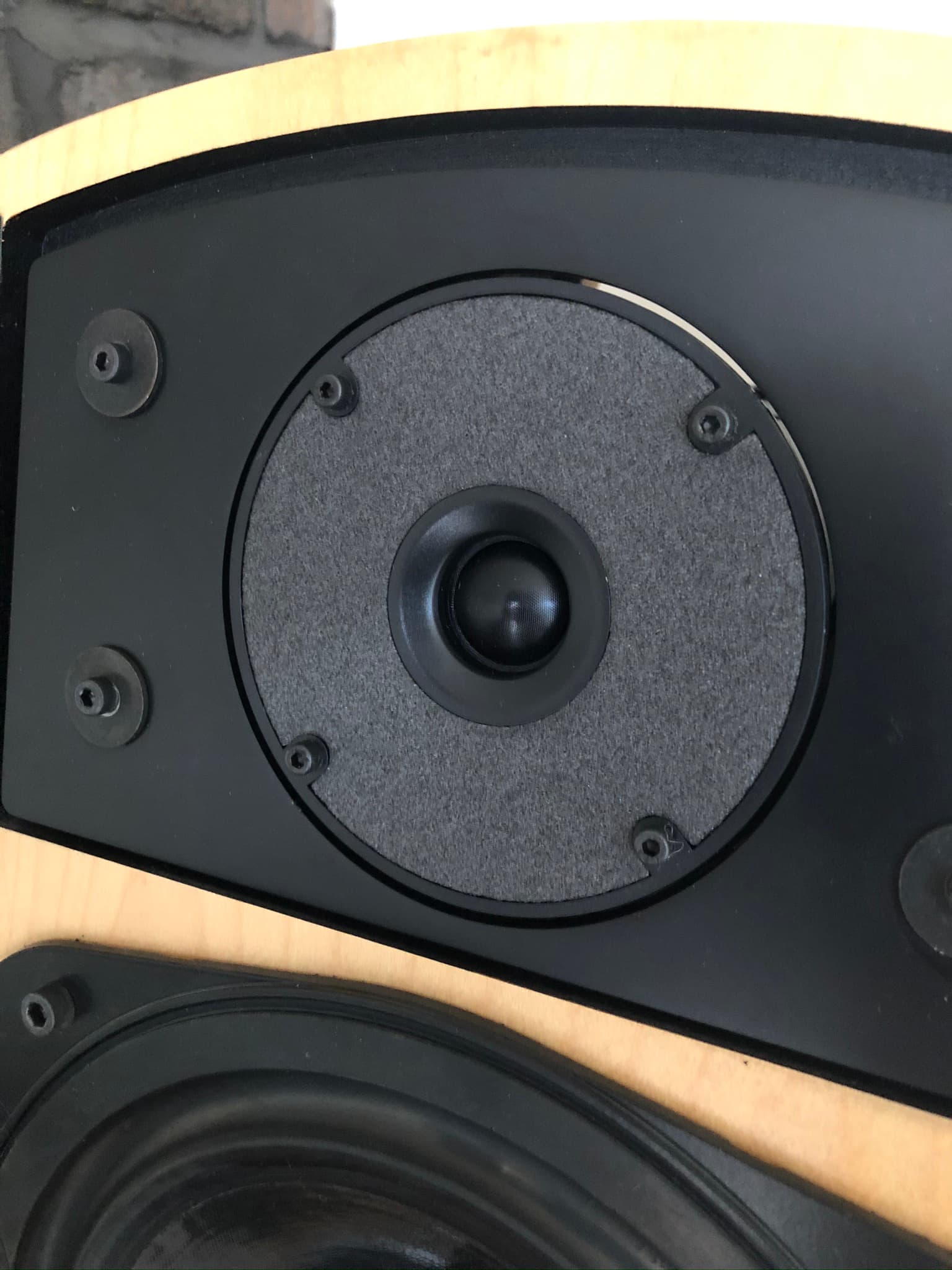

And this was the replacement:
