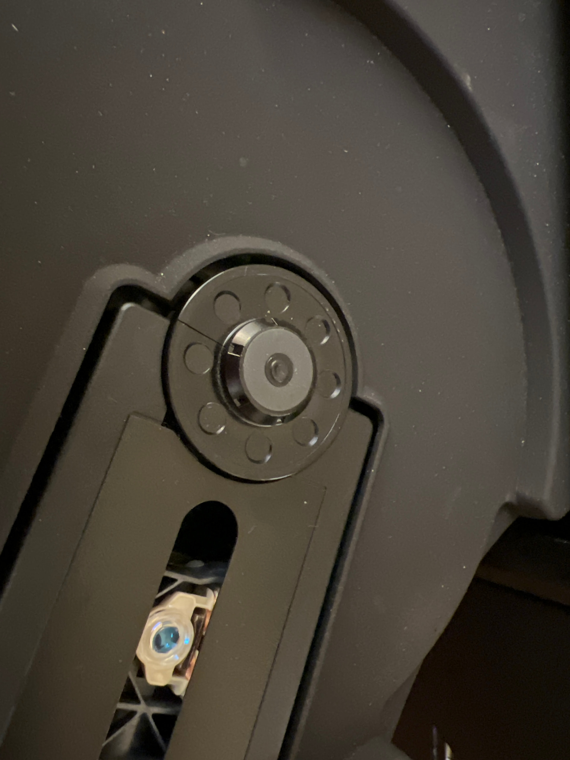

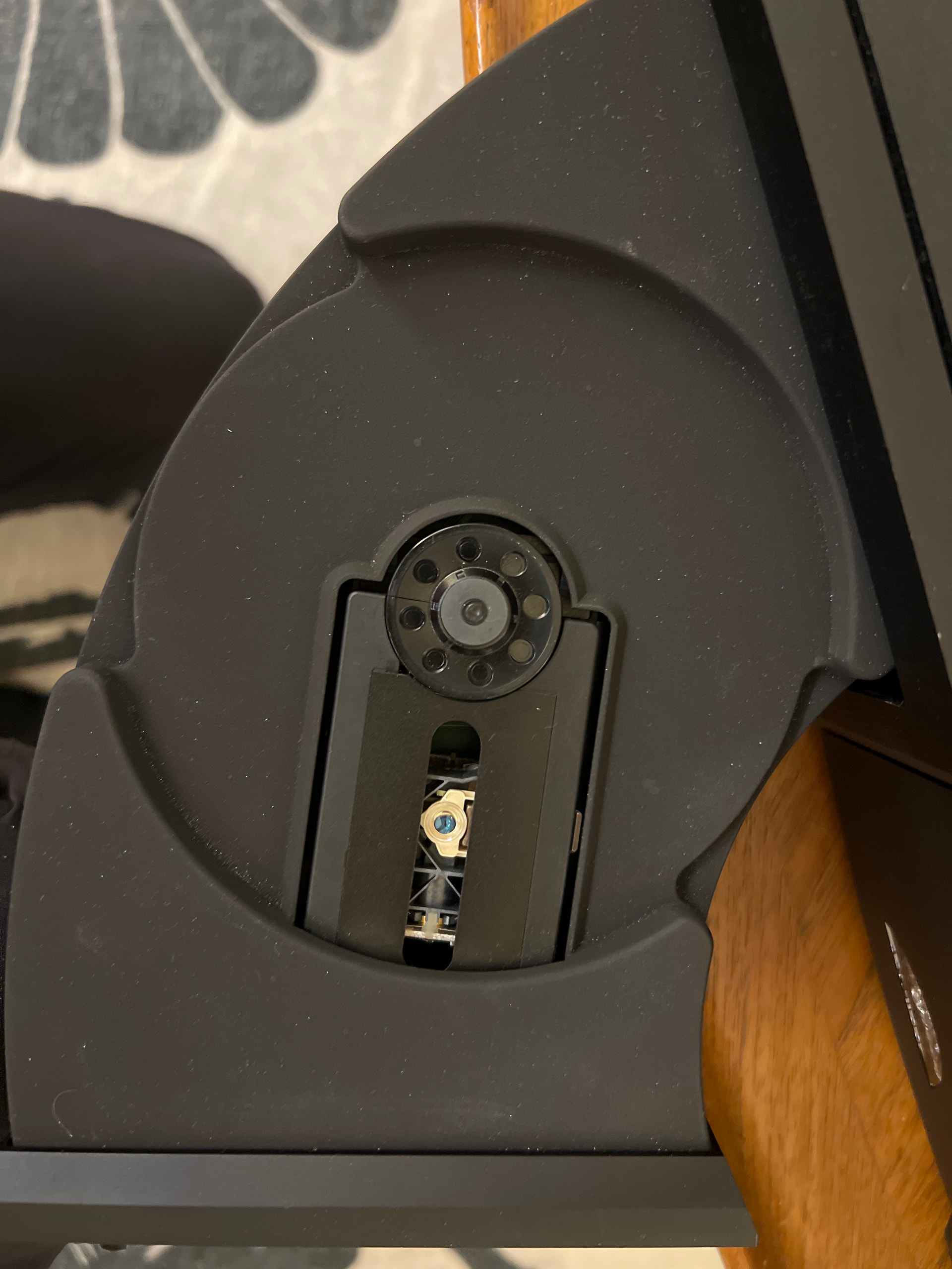

@NeilS I don’t see any cracks in the disc platter. However, there is a radial crack in the ‘spinner’. Is that normal? Second detailed picture
I think your best bet in that case is to hunt for second hand Naim CD players - but of course it can take a while to find one.
No, not normal & the platter will need to be replaced. Whether it is the cause of the problem, not sure, but it certainly won’t be helping.
Best bet would be to source a VAM1202 from the internet & ask your friendly dealer to swap the platter over for you.

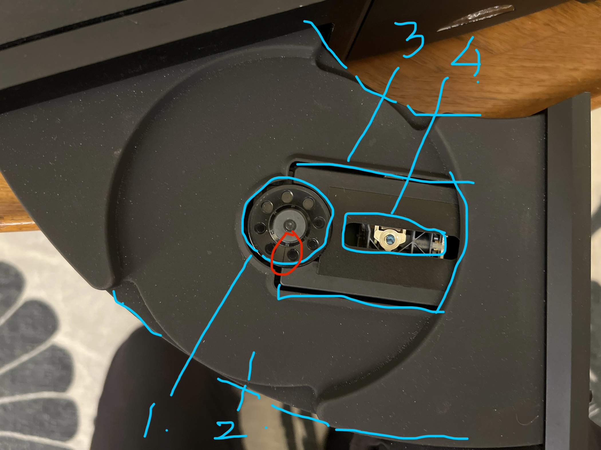

@NeilS for my knowledge sake, since I don’t know the terminology. Would you mind sharing what the pieces are referred to in the image call out below?
  1. Circular Cracked inner bit (where the magnet clamp locks the CD)
  2. Main CD platter (should the dealer replace this whole thing too?
  3. Squarish plastic thing covering the laser
  4. Laser
Your recommendation of swapping the Platter - would be 2.? Correct
And the Vam 1202/2 mech consists of 1,3 and 4. Am I reading that correctly?
Thanks
