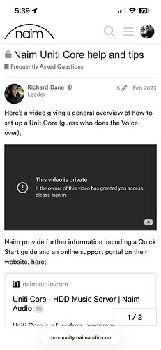

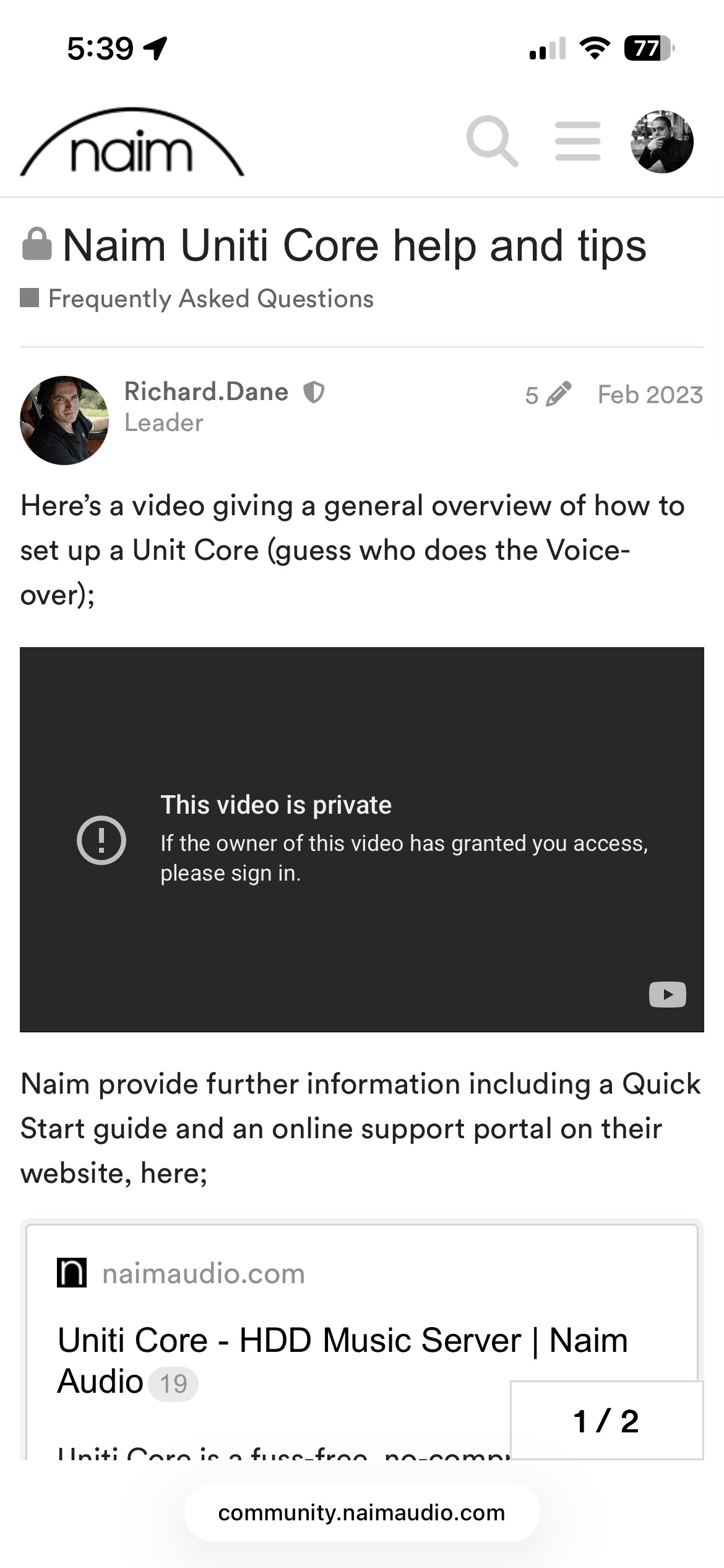

@Richard.Dane , when you have a chance - could you post the revised video showing the uniti core setup (screenshot below).

I’ve asked Naim to look into why it’s showing as “Private”. In the meantime, here’s another link for you;
The video on the FAQ page is now working again.
