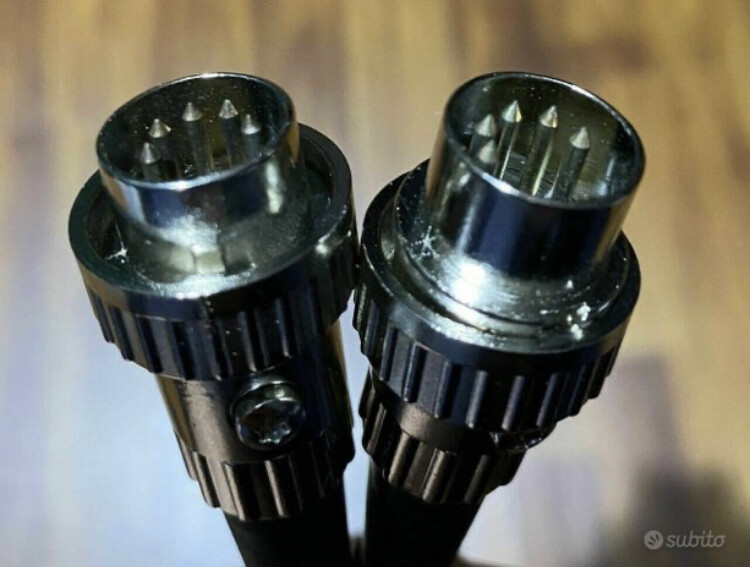

Do I need a Snaic5 180 or 240 degree?
As far as I am aware, all SNAICs are 240.
What IanRobertM said. I have a 32.5/110 in my main system. It’s lovely.

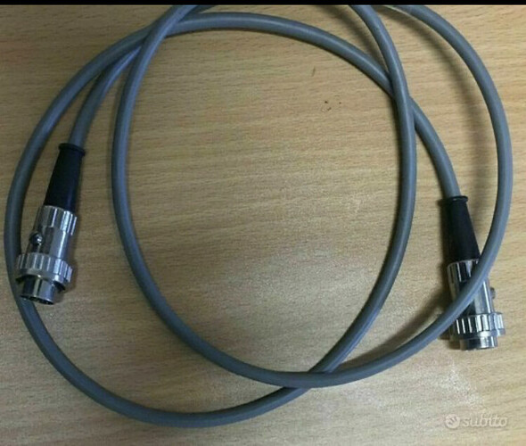

I found this one, is a genuine grey snaic 5 180 degree
SNAIC’s can be 4 pin or 5 pin. 5 pin is 270 degrees - and is used to connect a HiCap, or similar… :smile:
A 180 degree 5 pin DIN is used for signals - say between a CD player and a Pre.
That looks like a (genuine) grey Naim Interconnect, but not a SNAIC…
SNAIC are used (mostly) between Pre’s and Power’s and/or Power supplies…
They carry 24V DC power - as well as the audio signals…
Hence why they should not be messed with, or substituted… :expressionless:
