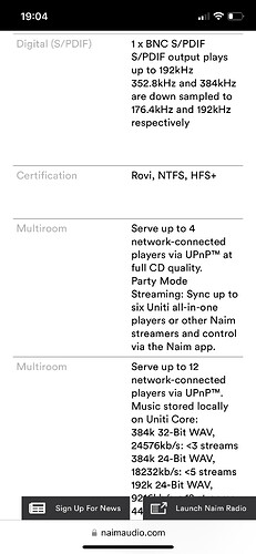

I have been looking into this - apparently the down sampling is unavoidable when using the local digital output on the Core with DSD files.
This is down to a limitation of the processor platform I’m afraid.

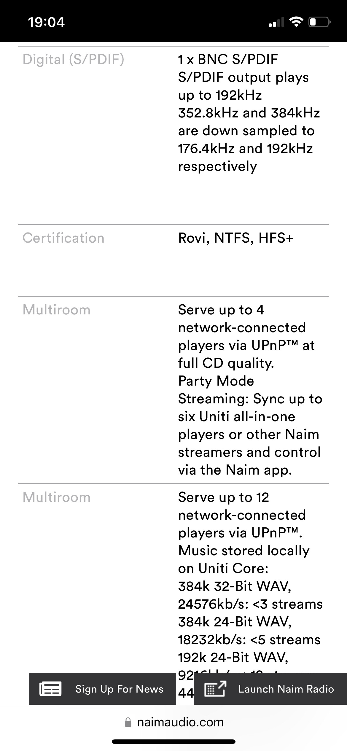

The specifications on the Naim website state clearly that the spdif output will be downsampled, whereas upnp won’t.

DSD via S/PDIF will be 16bit.
