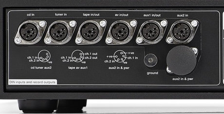

Unfortunately, as you’ve found, you only have the pre-out to use on the Nova. Normally you’d use a Naim preamp / integrated to feed a signal to the Headline and these provide an output (the out on the in/out capable DIN5 sockets). This is fixed and independent of volume control and mute settings.
Without unplugging the speakers, you don’t have a lot of other options.

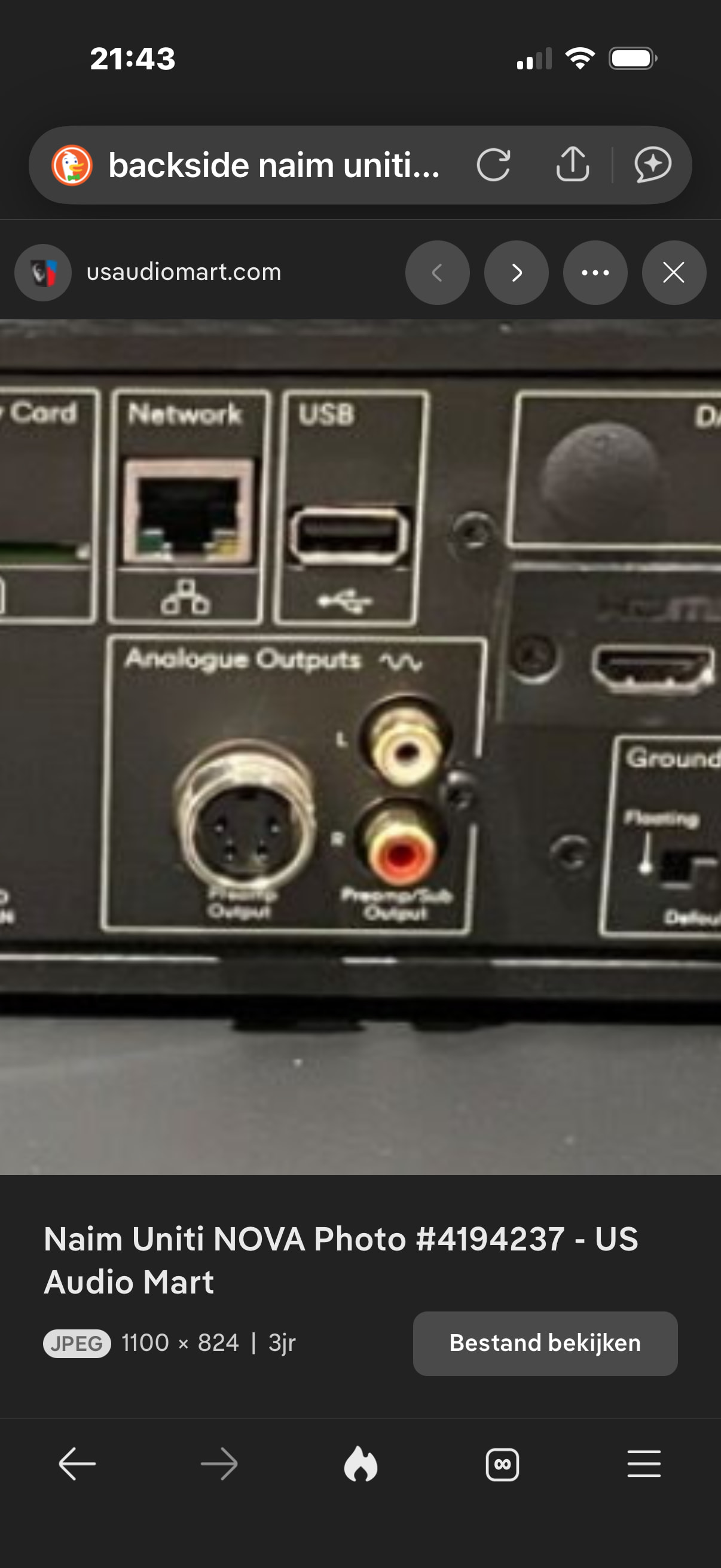

Thanks! I have the DIN sockets on the Nova. Do they have a different output. Is pre-out not the same as Pre-Amp out?
Yes, you have inputs on the Nova via DIN5 sockets, but these do not have an output capability so a no go with the Headline.
By pre-out I meant preamp output (as it’s labelled on the Nova)
Yes, it is a a DIN4 socket, but it’s still your pre-amp output so you run into the same issues as using the RCA (cinch) sockets, in that it is not independent of the volume control, mute function.
As I mentioned further up the preamps and integrated amps have sockets (tape, av, aux1) which provide inputs and outputs which can be used to connect a Headline to. Unfortunately, the Nova does not have this capability so you’re left with the preamp output and the limitations you’ve already found using this approach.
Edit - this may help explain things
There is no way to do this other than unplugging the speakers. But the headphone amp on the Nova is pretty good anyway.
