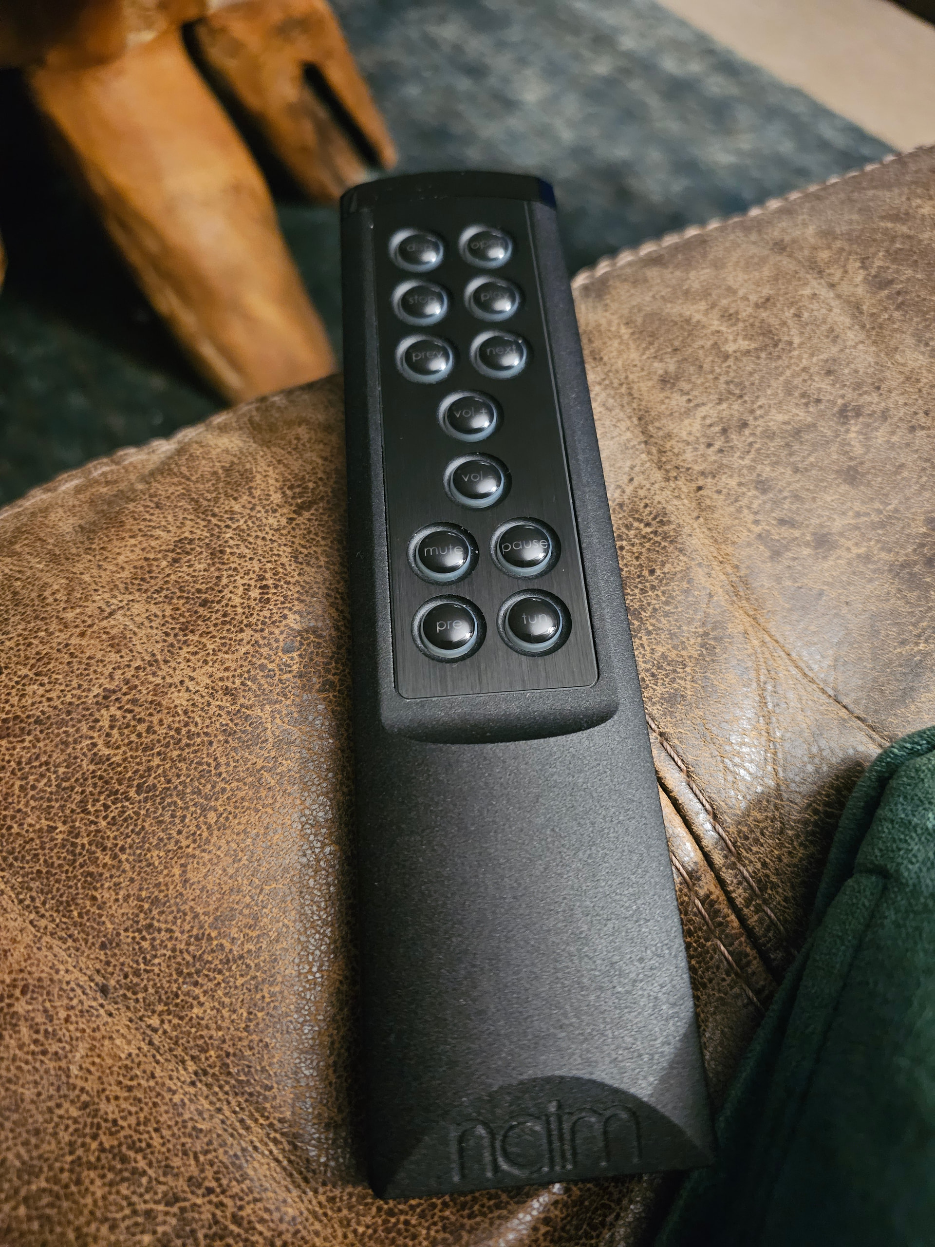

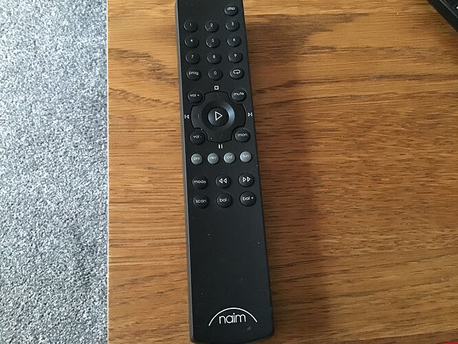

Naim use the RC5 code set, so you may find that another RC5 handset for a pre-amp or integrated amp will also operate some functions on the NAC82. Of course, it’s no substitute for a proper Naim Narcom, so I would get one of those if I were you - any generation of Narcom will work here, although for a NAC82 the original would have been a Narcom or Olive Narcom 2.
If you want the discrete RC5 codes for custom install control then you should get in touch with Naim support.
thanks for the advice on this @HungryHalibut and @Mickyh I have now purchased a remote and copied the codes so I am automating this in Home Assistant, cheers
