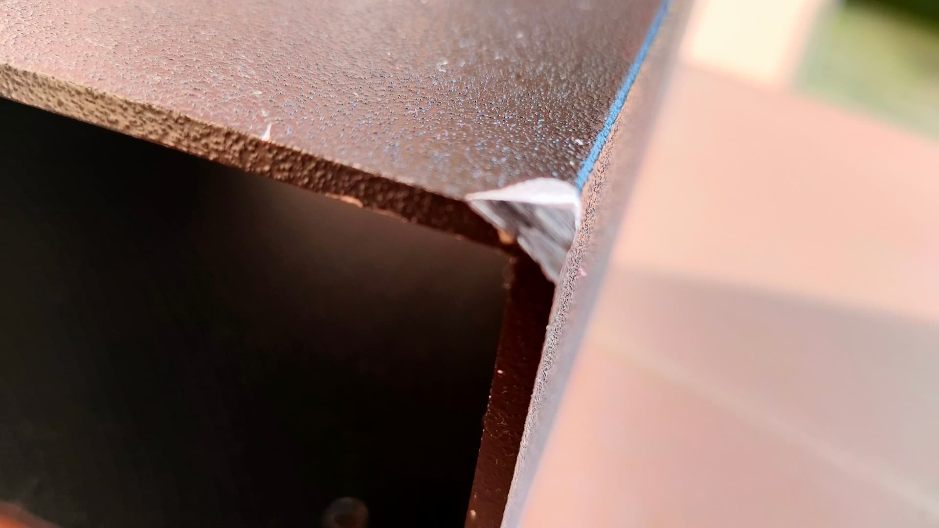

A rear corner of the aluminum chassis has taken a hit and is uneven.
How can I intervene?

Can you show a picture of the damage to the chassis?

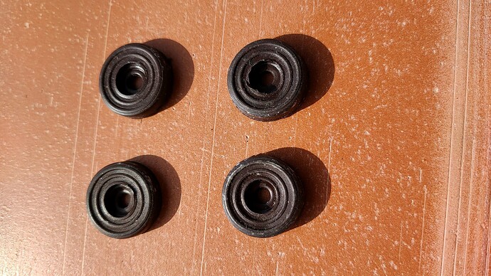

I Also round these Rubber feet which i don’t think are the originale.

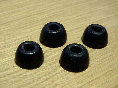

No, those aren’t the originals. The originals look like this;
Oh, that looks nasty. Your best bet would probably be to hone off any sharp edges and then blacken any exposed aluminium. At least it’s at the back so it will not be so noticeable.
I thought the same. Use a file and very fine sandpaper and then find a suitable paint to cover. It cannot be expected to be as good as new after 40 years. By news I would have already found the 42 at an acceptable price and in “excellent condition”.

That damage looks quite nasty. I would be more concerned about any harm caused to components inside that above damage to the casing.
If you want to restore the shape of the case I would use a metal filler such as JB Weld, then square it off with sandpaper before colouring it black.
The conditions are good internally. Everything is firmly and in order. Recreating the corner with so little missing material scares me and I think it’s quite difficult. I am looking for rather a similar Ral paint avoiding to use the spray. I have already sanded the excess aluminum. With a small brush and matte black paint it should come a nice job.
In the meantime I have found some really nice replacement rubber feet and similar to what is indicated.

Gloss Black. Modelling paint, such as Humbrol, is a good option - imo…
