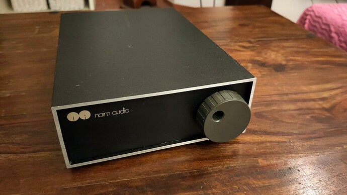

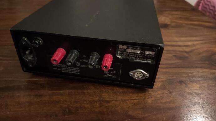

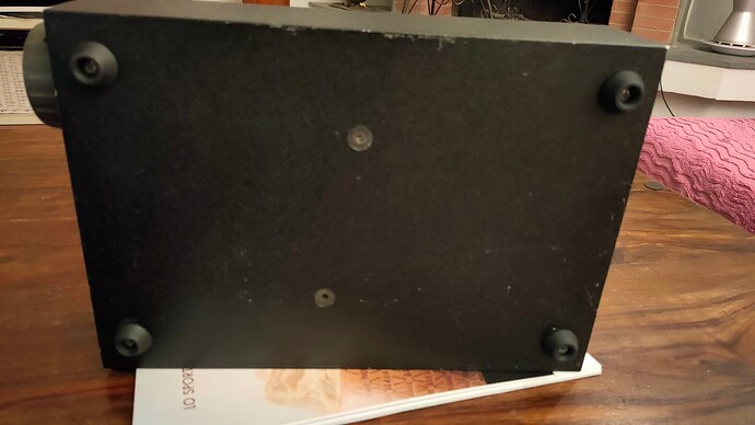

I replaced the rubber feet and touched up the edges with matte black. I am quite satisfied. In vintage it must satisfy us, in the sense that the signs of aging cannot be erased.
Greetings and thanks to all
The repair looks fine. Glad it’s found a good home - NAP110s deserve to be treated better than this old girl has :grimacing:
What’s it like under the bonnet ?
Mr Tibbs really!
What a thing to ask especially when she has just received some welcomed TLC :wink:

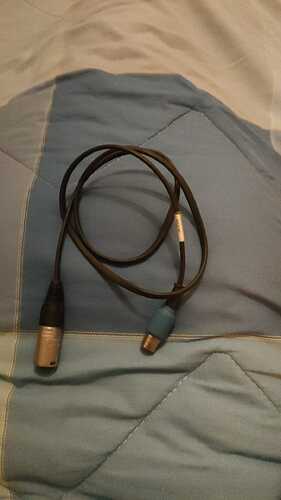

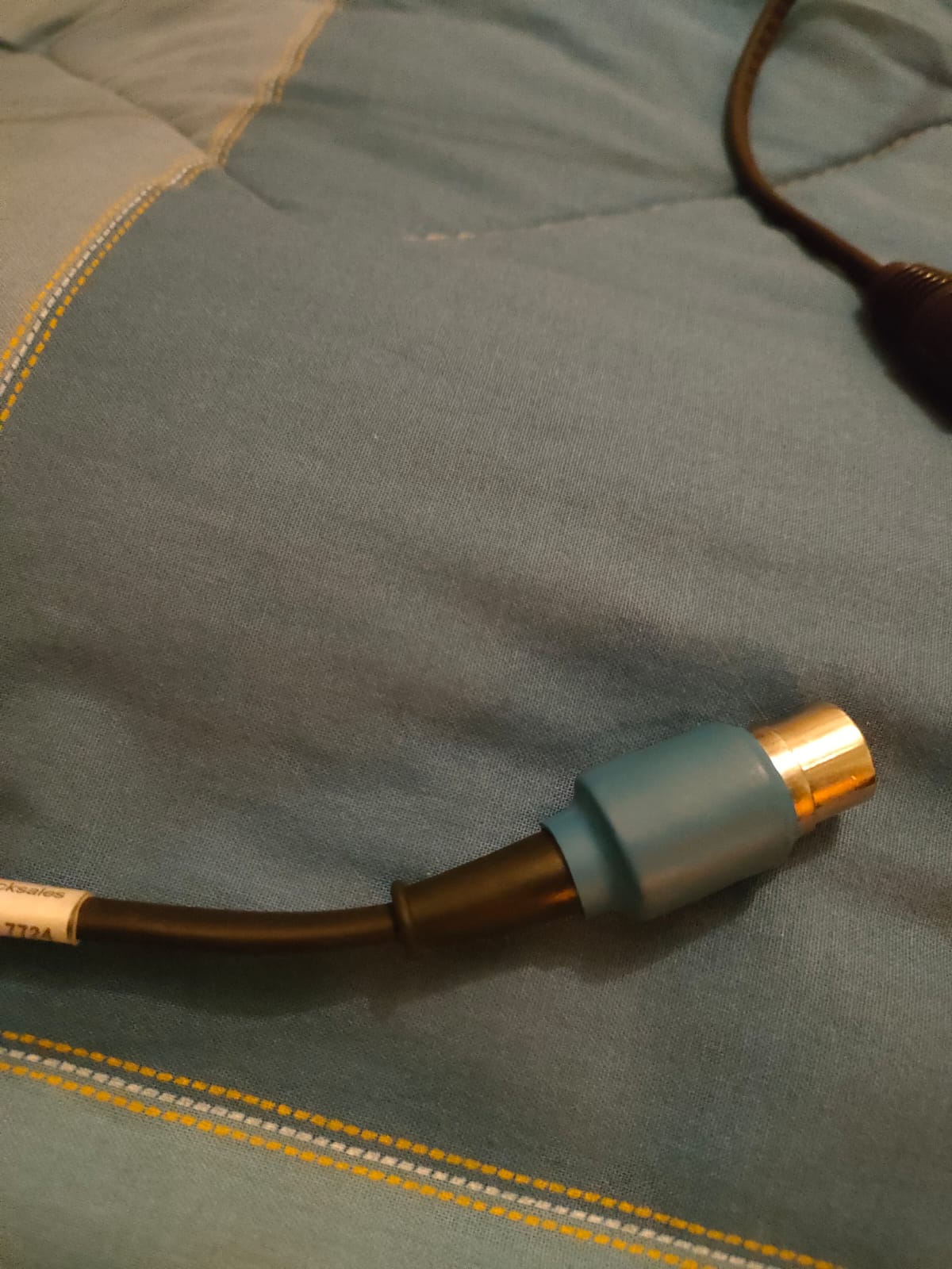

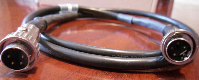

Good evening.Waiting for the preamp, I found this vintage flashback sales din 4 -xlr one meter long cable. I wanted to ask you: if I replace the xlr connector with a 4 pin deltron din that I already have can I get a good alternative to snaic?
No. The SNAIC is very different and includes a 24V power feed. Only ever use a genuine Naim SNAIC.
Sorry but no that won’t work. The SNAIC 4 and 5 are a dedicated and specially constructed cable that carries both signal and DC 24v power. Crucially though the cable outer screen is much heavier than is normal for a screened cable and the reason for that is to minimise the resistance of the ground connection, which is critical to overall performance.
New black (and used) SNAIC cables are quite expensive but would go a long way towards getting the very best from your 102 / 110 combo. Alternatively if budget is tight you could look out for a used grey SNAIC which will at least ensure the critical Naim ground system is working as intended.
NACA5 is ideal, but if that’s too much then the older NACA4 can be sourced secondhand, or else look for Linn K20, or similar cables from Cable Talk etc.
