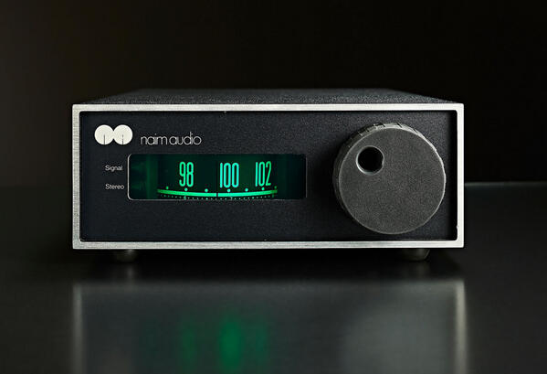

So I just took delivery of a NAT01 (olive) and have set it up in the system.
I have an external aerial - one of the ā€œOmniā€ variety - and although the Nat is picking up a clear signal on the stations I’m interested in - R3, R4, R2 - I note that the ā€œstereoā€ led on the left of the display is not illuminated on any station that it tunes to (the ā€œsignalā€ led is illuminated)
This means that I’m hearing the replay in mono and I’d obviously like to ensure that I’m getting the very best signal for the NAT and have the full stereo effect.
It was from a very reputable Naim dealer who did an extensive test before sale in his own system so absolutely no concerns re the tuner itself.
I suspect that I’ll need to get my aerial guy round to assess the external aerial options given the signal strength and position in relation to the various transmitters around Bristol.
If anyone has experience in this and can offer any insights that would be helpful.
Dave - As you’ve already found, it sounds like the signal level is too low for the stereo light to come on. The Naim tuners need a decent signal level to perform at their best. You’re looking at a directional Yagi antenna - 4 elements at least looking across the water to the Wenvoe transmitter, not far from Cardiff. A decent aerial installer will be able to advise and install what you need. If you can accommodate one (and they are a bit of a beast both in looks and mast needs) then a Ron Smith Galaxy is about the best you can get for these tuners.
