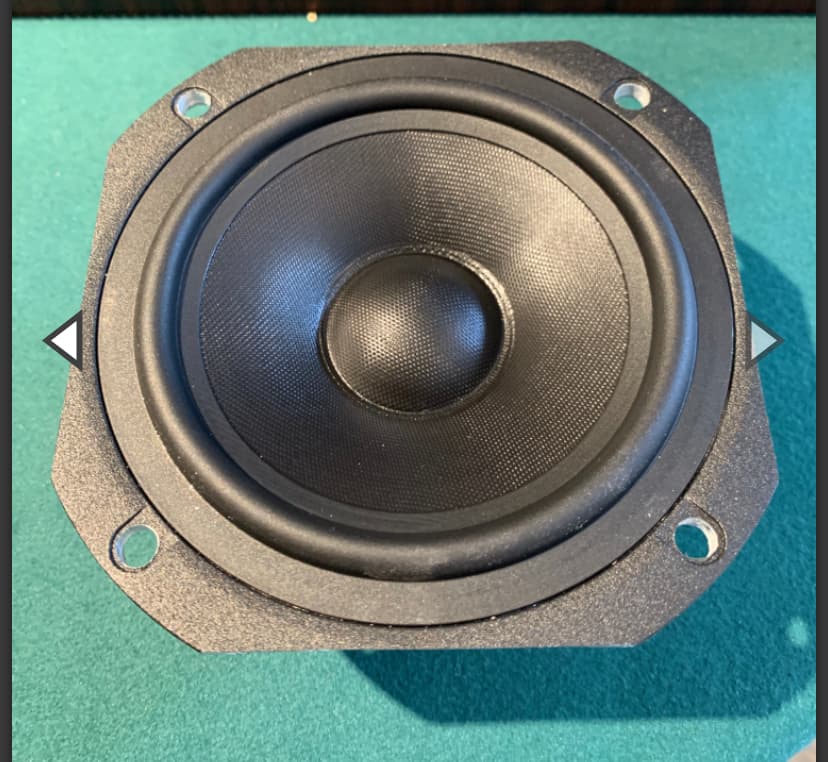

Scan-Speak Discovery 15W/4424G00

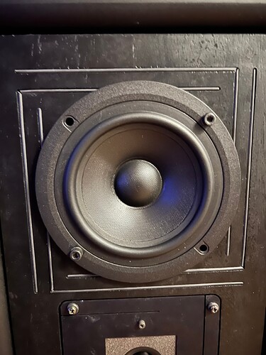

I didn’t do anything special, the speakers came up. I think I’ll cut them a little later to give them a square shape. Now they are a little more than necessary, look at the photo.
How do they sound now compared to when you had them with the original midrange?
Now there are very big images. It seems that giants are singing. I think this is due to the fact that the acoustics do not stand on the spikes and the speakers should work for 100 hours. I haven’t heard this acoustics with native speakers at home. I had SBLs, and I only heard NBL from a friend. Before that, I had a system entirely from Audio Note, AN-E Lexus Signature acoustics and now works with ASR Audio, but I want NBL. Audio Note acoustics for lamp amplifiers, ASR is very powerful for it.

Good to hear that these scan speak drivers (15W/4424G00) we found may actually perform up to the task. As you can see the ones I brought with me have been cut to fit the cabinet better. But so far I have not dared to try them.
