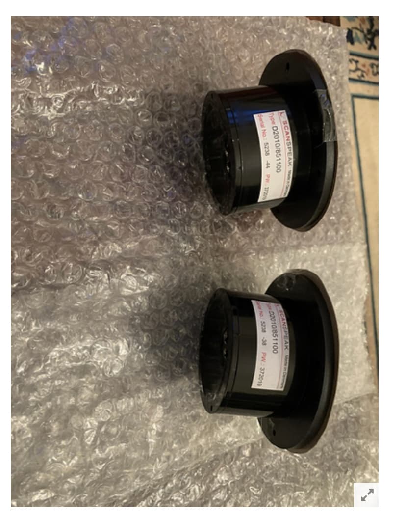

I have just purchased new Tweeters for my DBLs from Willys HiFi. The new ones are D2010/851100. The one`s I took out are D2010/8513 which according to their website is their Classic Range for Proac and Spendor. Did you find the same when you changed yours.

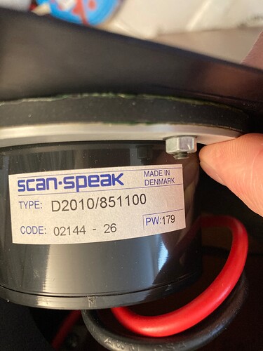

From the photos I can see that one of the old tweeters was definitely a 851100. Can’t see the label on the other one, assuming it had a label, but it was clearly second hand and at some point had something cylindrical glued to its backplate. Also recall that there were various bits of hardware (washers, reinforcing ring) missing as well.

The tweeters I got new from Cymbiosis
I still have the old ones somewhere in a box too but think were the same

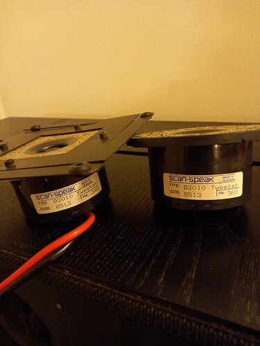

These are the Tweeters I took out. Either they have been changed for the wrong one`s in their life, which I doubt by the state of them or Naim changed what they were using at some point.
This is what came out of my NBLs, one of them was original Naim with a match code, the other had been replaced but the numbers were the same.

The 8513s are very similar but have Ferrofluid whereas the 8110s that Naim used were without Ferrofluid. It looks like someone may have changed the tweeters on yours at some point.
