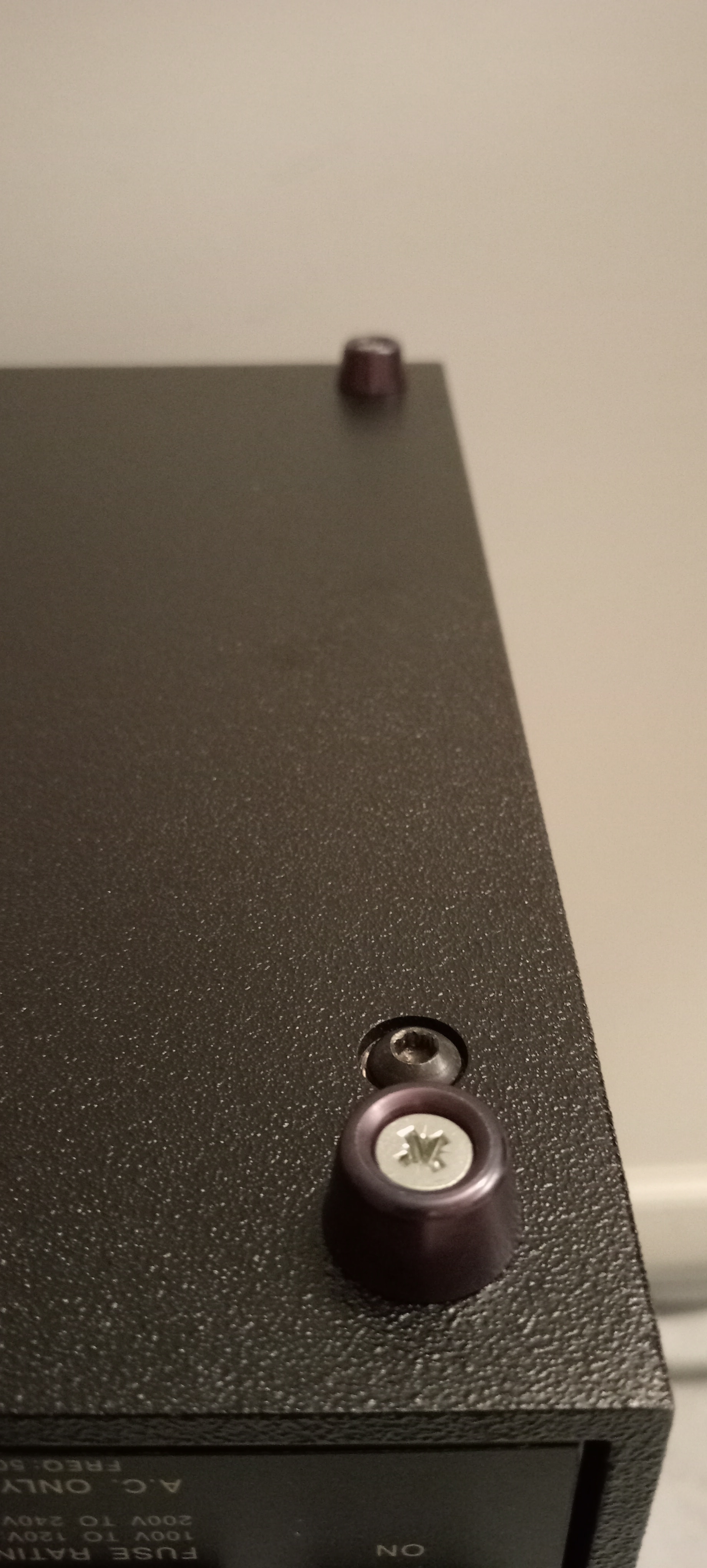

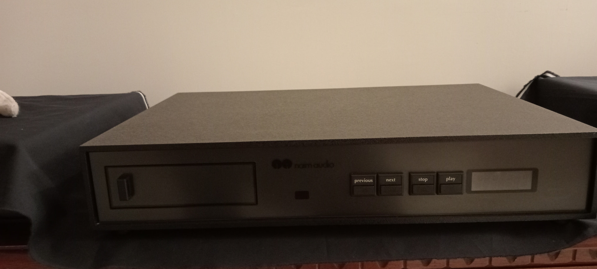

CDX landed today, it seems really in good condition, however the puck is missing and hearing a rattle inside, i suspect that It was left inside prior of shipment. I tried to open It but the screws are very tight and look bigger than usual, feet don’t look correct either
Without having looked at mine, I think you need a Posidrive #2 for the feet, and a Hex head for the “earth bolt”. Can anybody check/confirm?
Be careful you don’t strip the hex bolt or screws. You can try opening the drawer, picking up the player and slowly manipulate it so that the puck falls out of the opening. I’ve retrieved a few pucks from a CDX2 this way.
Your CDX2 is a beauty!

Earth Bolt is usually easy to undo. The problem are this feet really really tight, i never saw one such these, i don’t think being original. In case i already have a spare CDX2 puck, but the idea to have one lost inside is quite concerning, ultimately i will have it inspected by LASA. Aside this, it seems in mint condition overall

Agree the feet shouldn’t go too tight (i.e. finger tight+screwing for the last turn) or it will deaden the sound. And yeah should take out the puck as the chassis is for signal grounding you want minimal vibration.
The transit screw was properly fitted and it was properly packaged in a OC carton with additional padding
The feet should be aluminium. If not then they have been changed.
Do you mean the aluminium feet like the CDX2 or smaller?
No, they are like the CDS/CDS2 feet. They look right, although I’m not sure about the screws. Perhaps @NeilS can take a look and comment.
Thank you Richard
they are the wrong screws definitely
All looks correct to me!
There will be a very slight rattle when the transit bolt is out, as the bush in the chassis is free to move.
