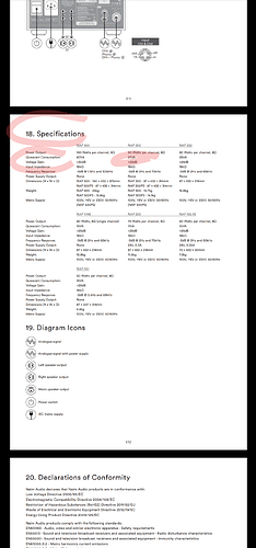

The manual contains the consumption, here it is for the 300:
I suppose you will find it in the 272 manual as well.
The VA value is equivalent to Watts. The year has 8760 hours, so 27 Watts idle consumption is 236.52 kWh per year

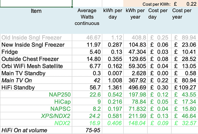

Don’t go by the manual. That’s instantaneous consumption. The numbers won’t add up right. Get a wattmeter for $20, program in your average cost per Kwh and stick it on the system.
You’ll find that for a bunch of boxes the usage is negligable and cost very little compated to heating etc. I went around with a wattmeter just this week after an astronomical bill. The stereo on standby was about 5 watts and cost about $12 (non Naim and I’m Japan).

As mentioned, power meters are a great way to check what you are spending. Below are some of my workings for different Naim kit. As you will see I ditched the old inside freezer (on freecycle) and got a new one, to save £66pa. Helps a little against the £100pa cost for the HiFi usage.

Ok, I always went with manual information for all my gear, Naim or not, and the idle power was always approximately correct. I guess a meter is better but I note that @GadgetMan’s meter result is close enough compared to the result based on the manual
