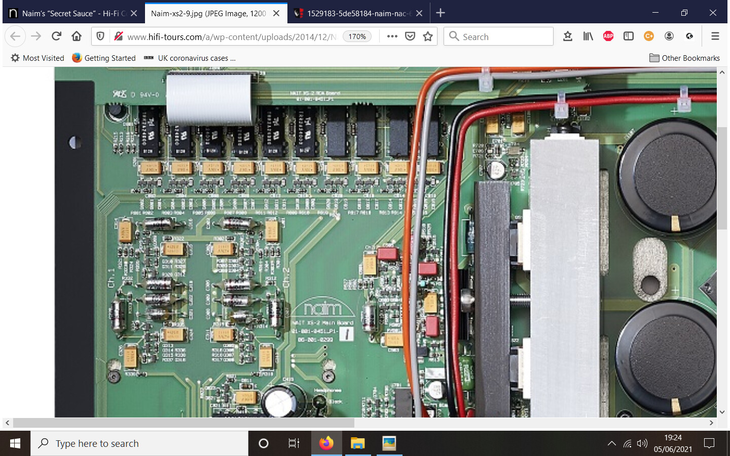

Tantalum Capacitors.
Coupling. De-Coupling and Feedback.
Beads in the older stuff.
Surface Mount in the newer stuff.

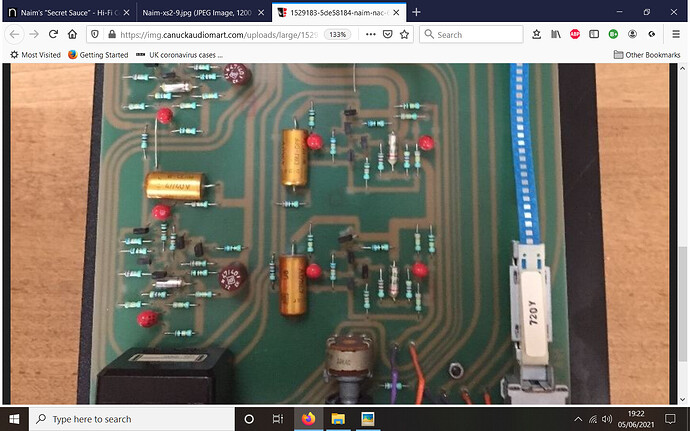

The power supplies. Having bandwidth over the audible range. On one interview Naim talked about selecting the LM317’s (before DR) based on the shape of the noise floor of the devices and so on, and let’s not forget those golden Roederstein caps that used to sit in the signal path.
