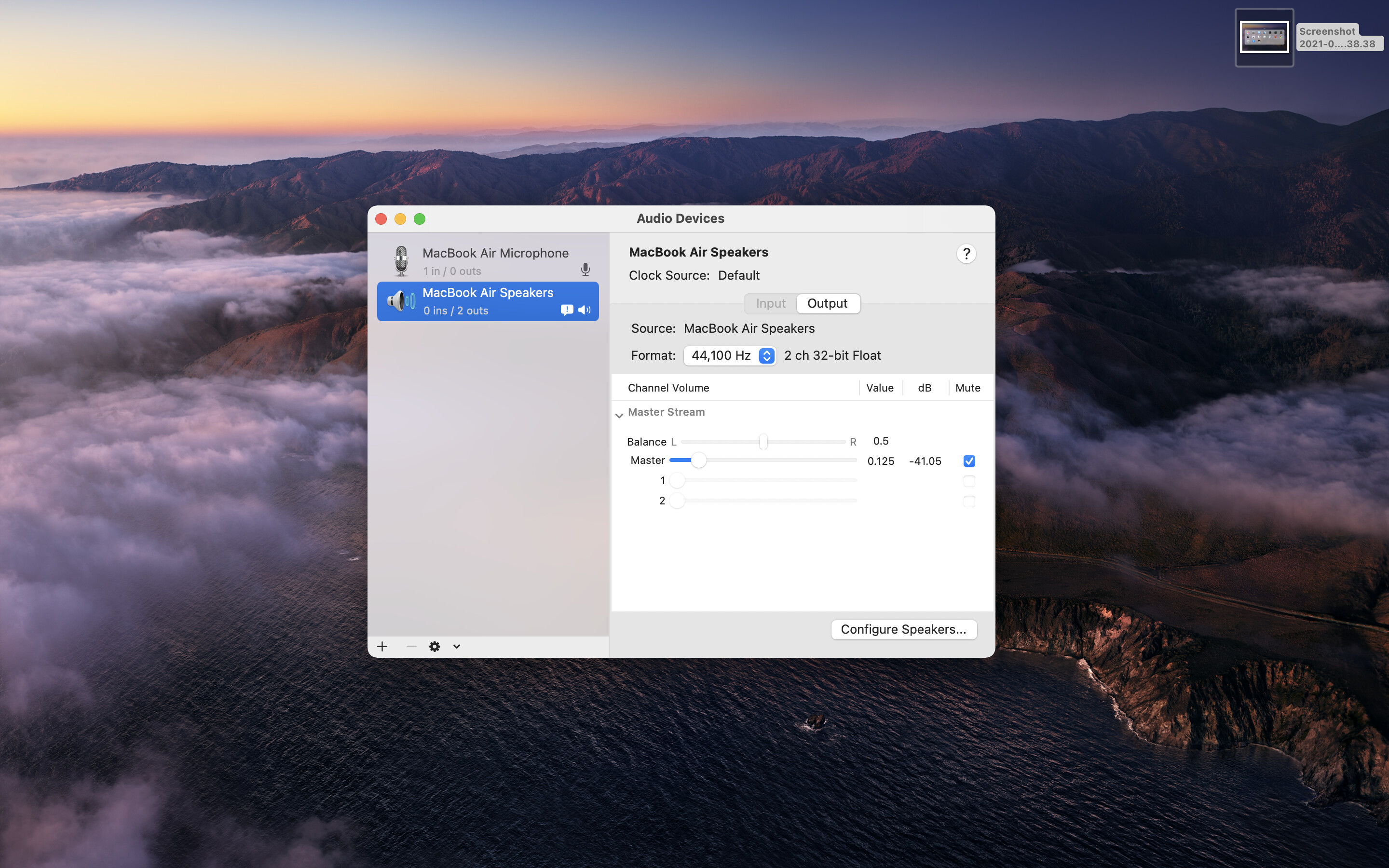

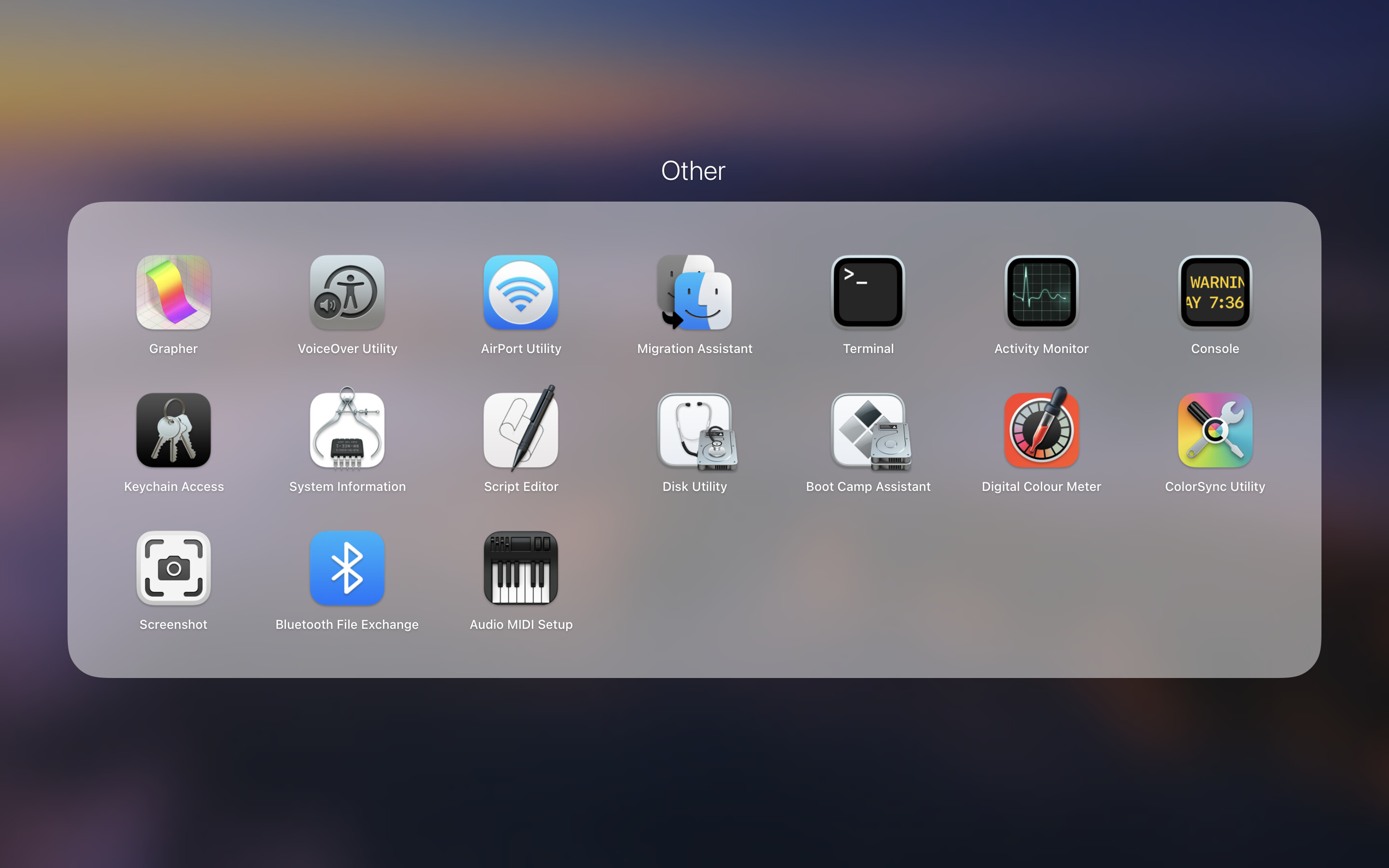

Steve,
macOS doesn’t auto select the digital out sample rates, unlike iOS.
To configure the USB out you will need to jump into Audio Midi Setup and then choose your output settings. I think you may need to alter these for different rates.
Hope this helps.
Daz
Thank you dazjones,
So, before I play a high res lossless music file via Apple Music (either downloaded or streamed), I need to work out the bit rate and Hz of that file and then enter it into Audio Midi Setup?? - Do I have this correct?
Hi,
I personally haven’t used the Mac in this way, but I believe so. It’s all about matching the file format to the output. If listening to albums it’s not an issue, but if skipping around…… If you were to use a modern iOS device and attach it to the USB in on the Sennheiser using the correct Lightning Adapter it would format the output automatically for you.
