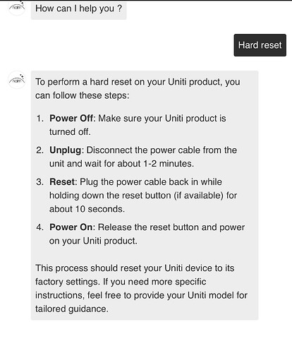

I read on the internet that many people have the same problem and that only a hard reset may help.

Gosh, I didn’t know the Nova had a reset button … :thinking:
Presumably this is from a bot. Unfortunately, one that doesn’t know the difference between the words ‘specific’ and ‘correct’.
Unplug the Nova from the mains. Wait a couple of minutes. Press the play/pause and input buttons on the front. Plug the Nova in, while continuing to hold the buttons. Keep holding the buttons for five seconds and then release. Let the Nova continue to start up.
Hopefully the volume control will then work. If it doesn’t, ask your dealer for a replacement unit. If it does, but then goes wrong again, ask your dealer for a replacement unit.
This information was generated by the Halibot.

I only unplugged it for a few seconds on the device, but that didn’t work. You really have to do it for the specified duration of 1-2 minutes. It must have something to do with the last firmware update.
Why doesn’t the administrator delete the bot from the top?
You have to love AI bots… At least it knows you should take it with a grain of salt: holding down the rest button (if available)
The Halibot was right though.
