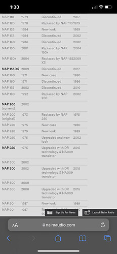

I will start with the Nap 200. I read somewhere that this was updated in 2015 to include the DR modification. Is this the only recent update? I purchased a used one from 2017. Serial no begins with 419. Is this the most recent version?
The website doesn’t seem to have this information.
It says that 2002 is the latest.

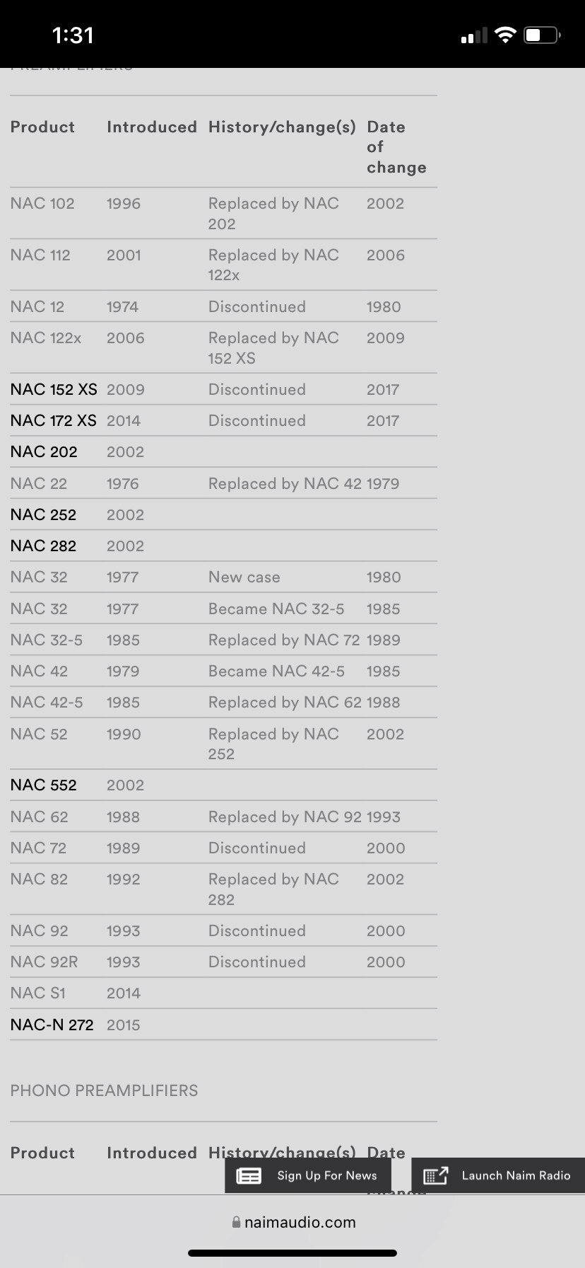

Next up, the Nac 202 is on my hit list and I would like to know if there have been any updates to this since 2002? The website doesn’t seem to indicate any changes, however, I have seen items for sale with very different remotes… is this just the remote changes or has there been anything internal?

Only change to the 200 was DR. No changes to the 202 I’m aware of. Caps and resistors are updated when something becomes unavailable or something better comes along. Not sure that’s worth updating the site for.
Sure, however, the site is updated for the 250, 300, etc to include the DR addition but not the 200. Which I know was updated. So it is a bit unclear.
So the 202 is the same, bar the remote. I would imagine that a new remote can be purchased and will work with older units?
The 200 and 200 DR are effectively the same amp. The only change was to replace the older LM317 based regulator for a new DR module which can provide a single rail 24v supply to a Naim preamp if needed.
The NAC202 is essentially unchanged bar one or two very minor production changes (IIRC one slightly lessened the switch on/off thump when powered directly from a power amp) and of course the move to ROHS compliance.
As for the remote, any Narcom will work fine - which Narcom came with the NAC202 will depend on when it was made.
