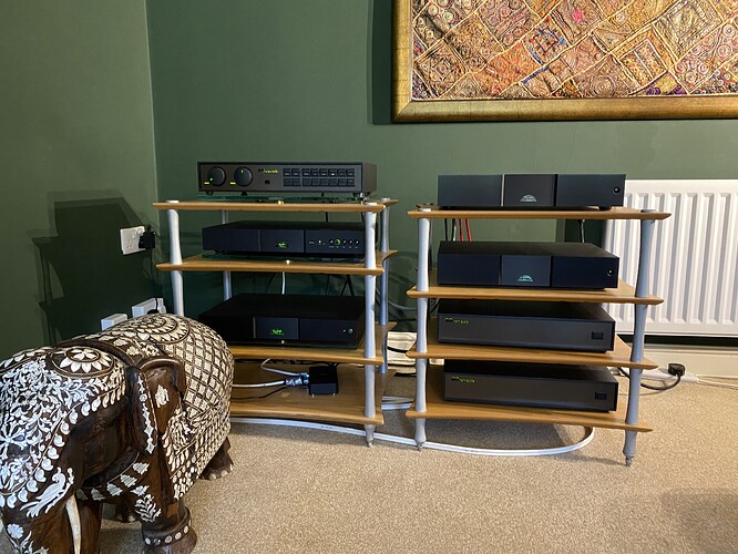

A six pack would be quite wide ![]()
I stack my Naim monoblocks on the bottom two shelves of my brawn stack.
Nellie is well chuffed with that configuration.
