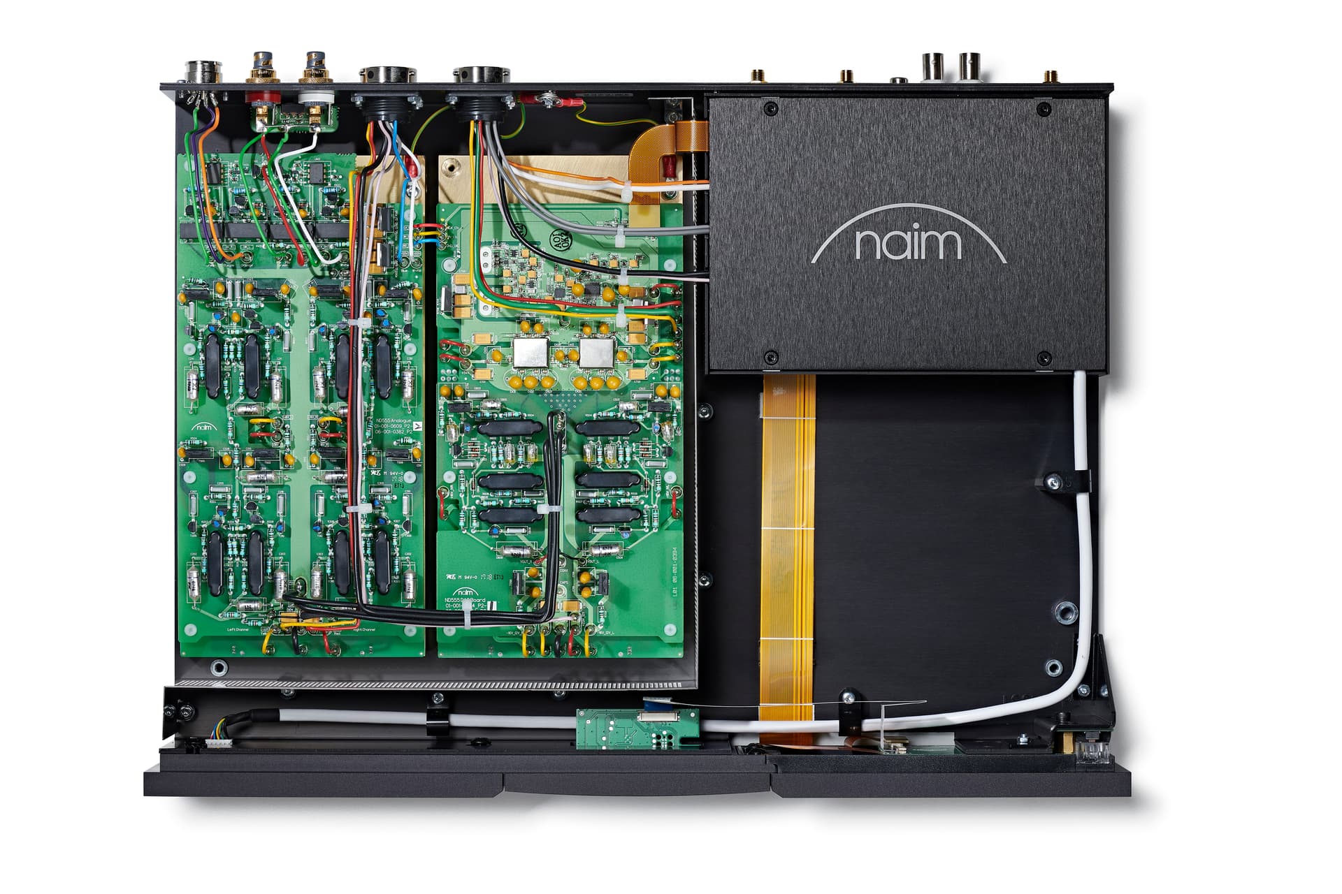

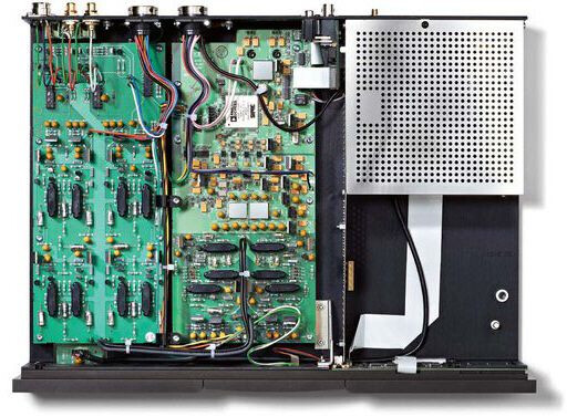

It should be aligned against what is on the back of the case inputs/outputs.
So the left is analogue output/filter stages - Middle is DAC and digital and right (caged) is ethernet stuff.
DB.
Sorry, was a plane for the day, as in Nairobi for the week.
Yes, from left to right you have the analogue output board. You can see the power input wiring from Socket 2, the output to the DIN/RCA connectors at the back and the analogue output from the board next to it.
So unlike the NDX, ND5XS designs (1st and 2nd gen) this board is physically separated and isolated. The other streamers have a large main board plus have to make way for a mains transformer and power supply components. Plus all the electrical pollution these bring inside the case work.
The next board is the DAC processing board.
On the NDS you can see the Analog Devices SHARC device which is performing the oversampling on the digital signal.
The DAC chips are under the metal cans, surrounded by Tantalum capacitors and on the NDS the black voltage regulators.
On the ND555 what I have read and tried to work out from pictures is that there are DR based voltage regulators either on the underside of the board or on a second board underneath. This board is also separate and isolated.
On the right is the streaming board, in its galvanic isolation cage. So here is the Networking cards (100BaseT Ethernet, WiFi etc), S/PDIF digital inputs/output, the rear USB connection, the ARM based microprocessor to control the network stream, provide the integrations etc. The power for this is clearly from Socket 1, with outputs to the front controls, display and USB socket. All this type of circuitry is electrically noisy, so in the cage and a metal divider. Again this level of isolation is only on the NDS and ND555, the other have a daughter board arrangement over the main board. So electrical pollution can occur.
Is is where the cost goes - separate boards, the isolation, the additional wiring, component selection etc. You are getting a lot for the investment :slightly_smiling_face:
Yes it is :blush:
As a comparison, here’s the ND555 interior vx NDS. Probably as many similarities as differences which is probably why the ND555 holds the number 1 spot with the NDS second as far as Naim streamers go, although current issues may have reversed this hierarcy!
ND555
NDS
