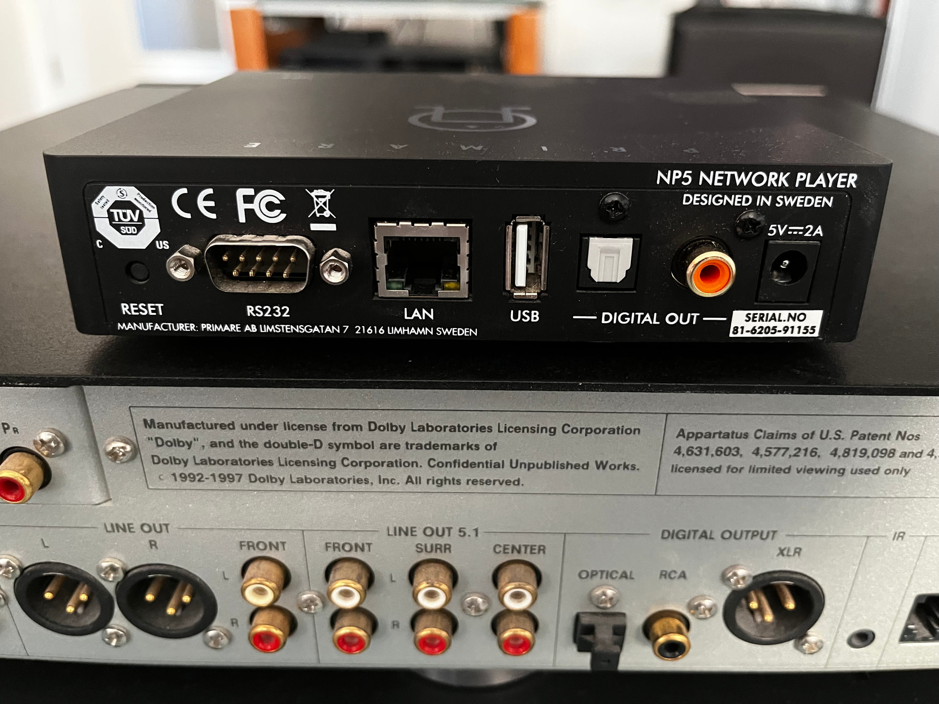

I have installed a Primare NP5 MkII. Simple, tiny device, decent app if a bit fussy screens.
I have tried two configurations.
  1. Primare wireless to network>Chord C digital RCA > NDS RCA. NDS remains wired ethernet to NAS (and for iRadio access)
  2. Ethernet > Primare > RCA > NDS. NAS now routed via the Primare so NDS purely as DAC for everything.
(Note I cannot get a separate ethernet cable to both NDS and Primare without lots of hassle)
The results.
  1. Totally stable Tidal connection wirelessly. Sounds good. Is it me or is there a difference comparing Primare and NDS Tidal streams. Is the Primare slightly sweeter?? This setup would have suited me fine but…
  2. Tidal is great but here’s the thing, the NAS files sound better than when played through the Primare than through the NDS. It is not night and day but I’d say a little more delicate, slightly ‘sweeter’ and more separation/soundstage. Bass is good, possibly a fraction less weight but no less pace or resolution. Overall the Primare might be a touch brighter or ‘lighter’ but never sharp or harsh. I’ve switched over several times and tried various musical genres but I’m sure I prefer the Primare as the source. This has surpised me!
I found a few other comments on the Forum with similar results. This is a £450 streamer with a £50 cable and stock power supply. It has definitely postponed any change in the NDS. Delighted. I just need to work out how the internet radio works through the Primare. Not done this yet.

I used Primare NP5 Prisma for several years to stream mostly Spotify. Also Hi Res files with Audirvana as a player. The NP5 gave my Primare AV processor a network capability.
I use a NP5 going into my Hugo2. A few UI problems but more than satisfied with the sound quality. A great streamer for very reasonable money. :grinning_face:

Another user of NP5mk2 here using as feed to NDAC and/or NDS. Listening experience as per O/P. Small issue reading full indexes of artists / albums when local streaming from my ancient U/Serve but seems to be a U/Serve related issue. Must investigate further sometime.

It’s extending the life of my 272 quite nicely.
The Primare NP5 is also improving the sound quality.

I thought it was worth a try and have added a £100 iFi X Power low noise power supply to the Primare NP5 and it has lifted performance further both on Tidal and local streaming. A touch more weight and bass extension (which was slightly lacking on the stock setup) along with extra clarity and a lovely airiness around voices. The whole setup is huge bargain for the uplift in sound. I bought it to give me more reliable Tidal streaming stability, I never expected this result.
The only criticism I have is the rather fussy Prisma app screen on my Android phone. Much nicer to use on the iPad although still not a model of clarity. Still, it works.
The NDS isn’t going anywhere for a good while I think.
