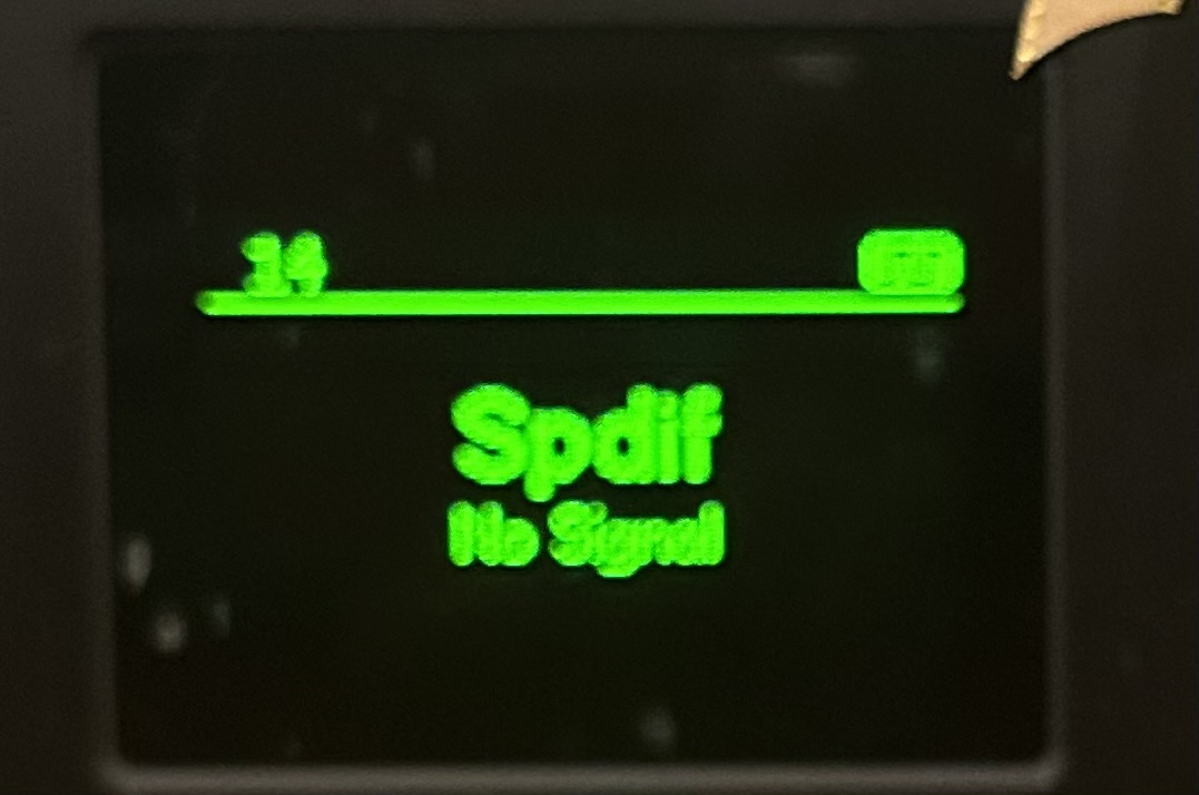

Have you got no sound or no lock?
i.e, on digital input is it showing “no signal”
Here’s our SuperUniti (same gen) if I pull the coax from the renamed digi input…
