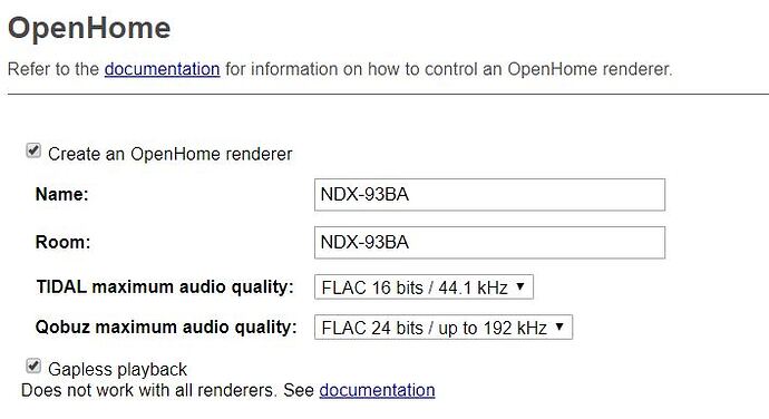

@jmtennapel,
Thanks for this, much appreciated.
I’ve configured everything as you have described.
Up and running now, I’m a bit confused to what the quality level of music is coming out of the NDX.
So if I login to Tidal through Linn Kazoo and stream a master quality track, the following is shown underneath the art work- ā€œFLAC 0 kHz/0 bit 1.4 Mbpsā€ . When I look under the Media Renders tab in BubbleUPnPServer, (see below)-
The highest quality in the drop down is shown as ā€œFLAC 16 bits / 44.1 kHzā€, the other option available in the drop down is ā€œAAC 320 kbpsā€. Should I be selecting the latter to get the highest quality? If not how do I get ā€œFLAC 24 bits / up to 192 kHzā€ like Qobuz? Is there any way to tell what bit rate and sample rate NDX is playing?
The maximum you will get with Tidal is 16/44.1.
Tidal masters use MQA which is not supported. Don’t get too hung up on this though as MQA is a lossy format
