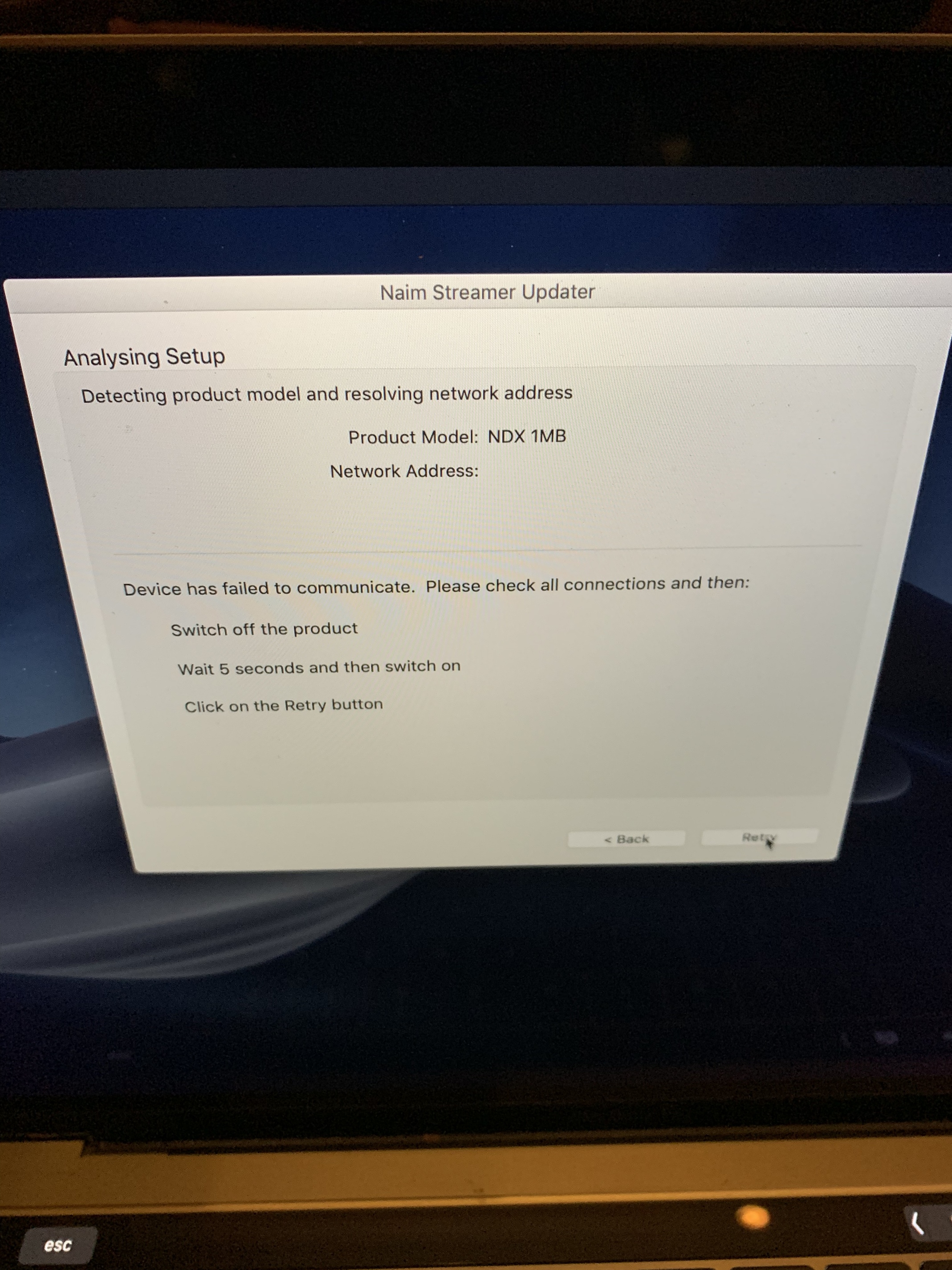

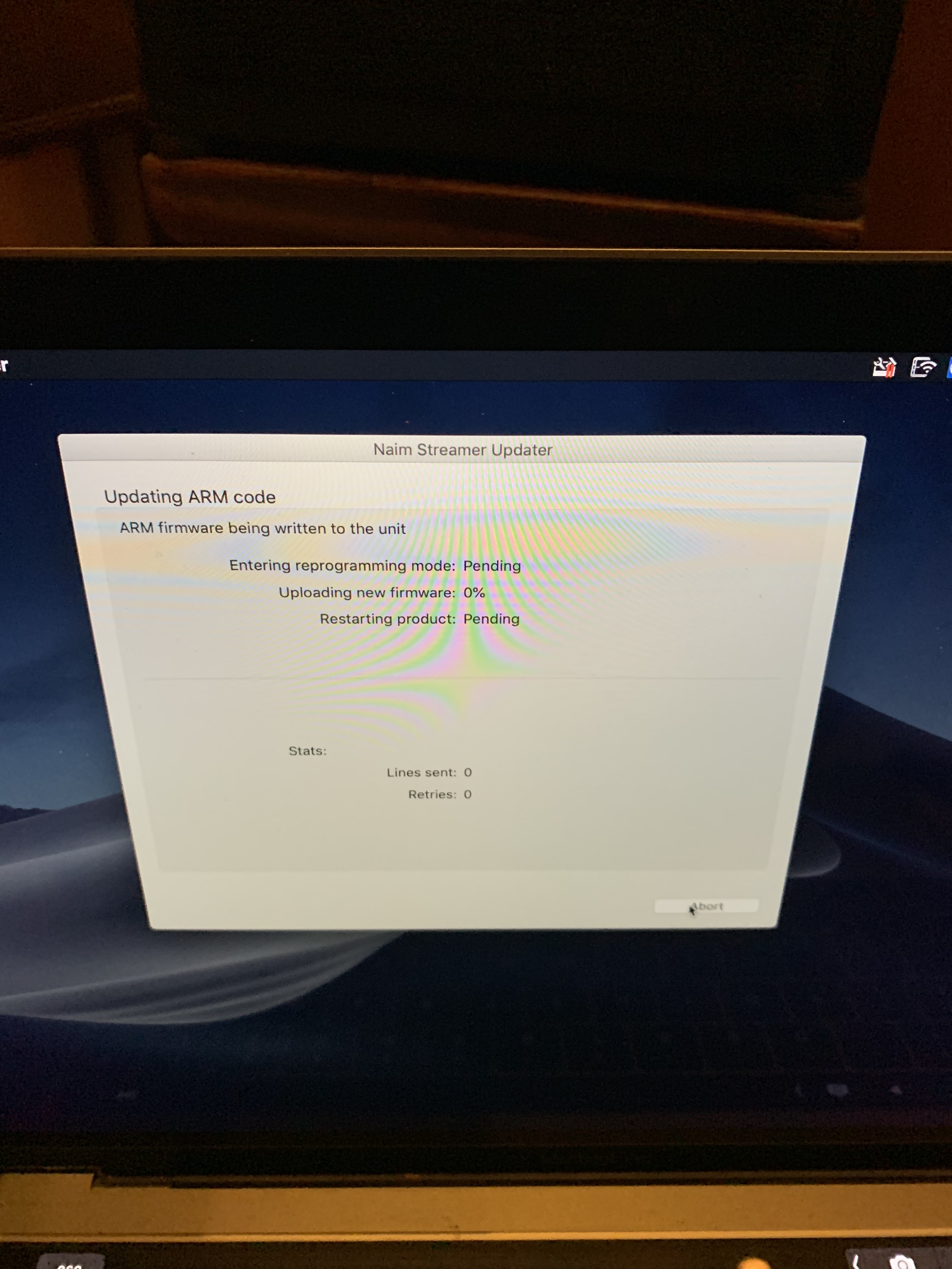

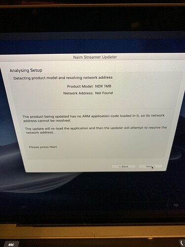

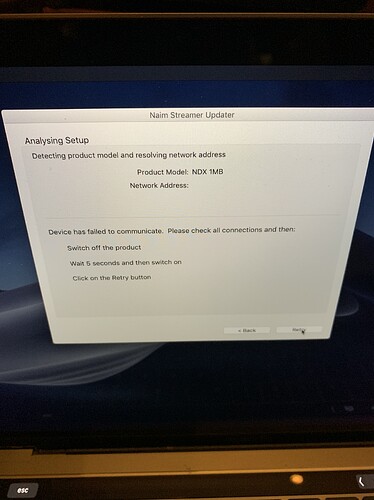

Today, I try to upgrade the firmware. Unlucky for me, the firmware upgrade stuck. I waited so long but no progress. So I have to abort the process. I powered off and on again but the firmware upgrade still stuck. Now the ndx complety cannot be used. I have to ask the technician again.
I assume that you are using the Streamer Updater tool installed on a Windows device to upgrade the firmware?
Does the update complete as far as the tool is concerned, or if it hangs or fails - at which point does it fail?

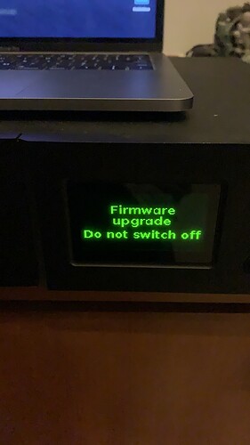

Hi, My naim ndx stuck on firmware upgrade so I have to abort the process.
After I powered off and on, the screen stuck on firmware upgrade, do not switch off.
So please help to resolve this matter. I love my naim ndx. It is old unit with no Bluetooth.
anyone, please help me…is there anyway to reset it ?

The update process is not complete, stuck in 0%
Are both the computer and the NDX connected separately to the internet, and the NDX connected to the computer?
