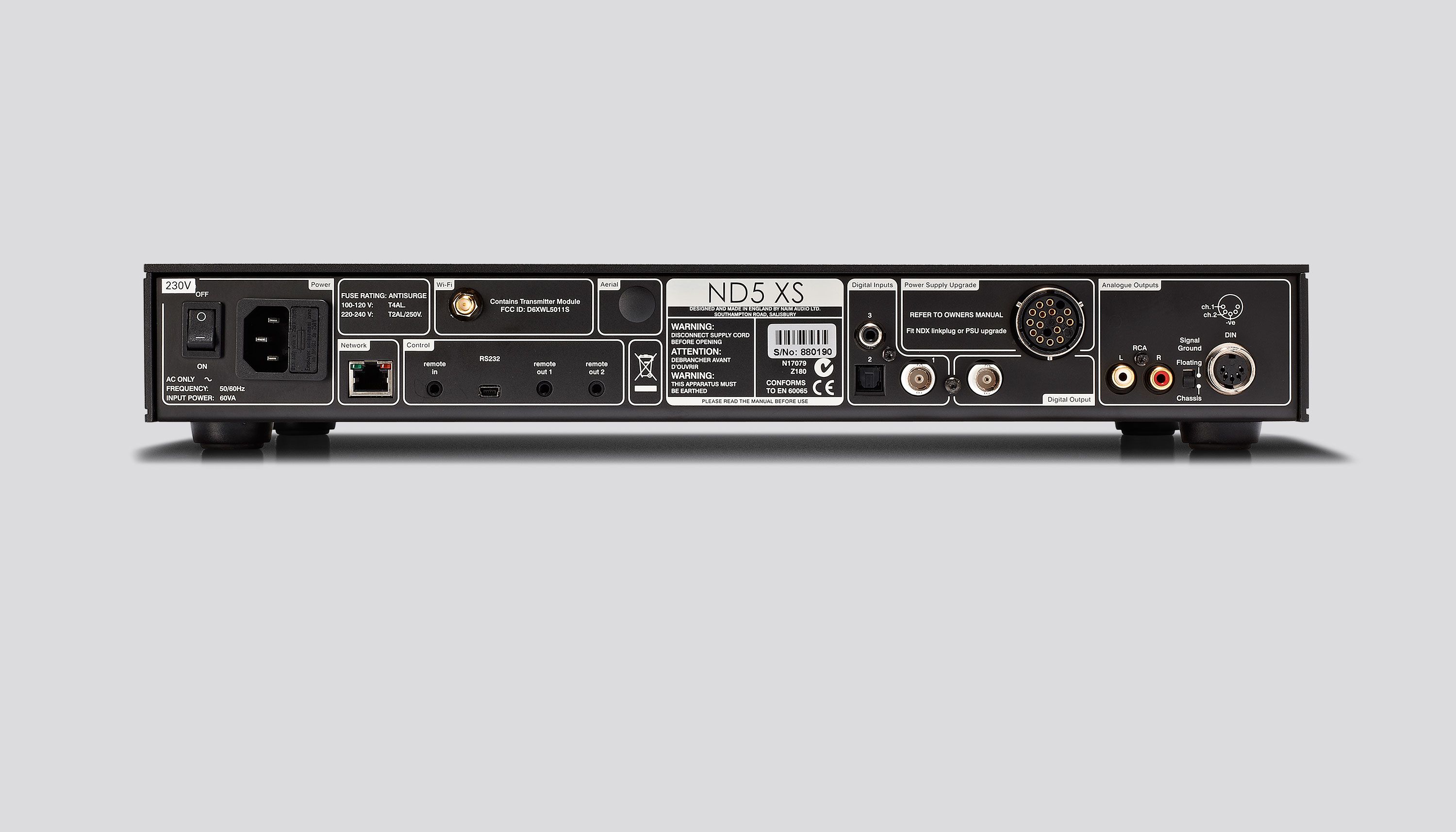

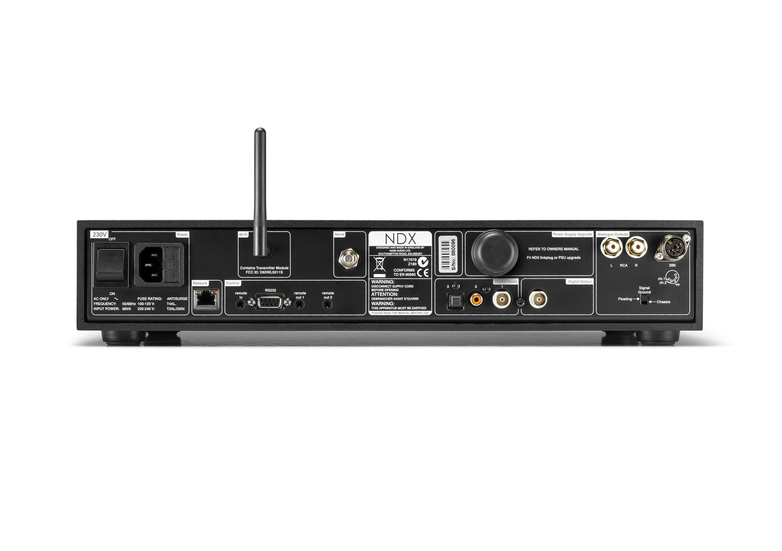

@MC2 I think you may not have an RS232 socket on your NDX. Here are two photos. The NDX here does have an RS232 socket but the ND5 XS in the other photo has a mini-USB which is labelled RS232…
Naim fitted mini-USB to all but the earliest production models of all their streamers.
This is funny and indeed confusing but I believe technically correct as RS-232 is a communication protocol (https://en.wikipedia.org/wiki/RS-232) and not a port specification. Various ports were used for RS-232 (the 9-pin port of the older NDX being quite common, https://en.wikipedia.org/wiki/Serial_port, but others like the 25-pin were as well). I suppose in this case it is RS-232 protocol over mini-USB, quite unusual :slight_smile:
Yes, you will need an USB to RS232 adapter. Naim recommends one that uses the FTDI or Prolific chipset. All and all an overcomplicated update process.

You don’t need that adapter if the NDX has the mini-USB (the OP says above that it looks like a mini-USB).
Ah,my bad. Thought he said it was RS232. But after closer reading I now notice he says it looks like mini USB and even says so in print on the back of the NDX. Sorry,hope I did not cause any confusion.

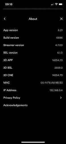

…at the bottom of the page you can select ‘Series Numbers’ and look up the year a product is manufactured. mouse click on Serial Numbers above and it will bring you to the page. You will see the number listed as 2011.
The NDX was introduced in 2010 and the version with the 192/24 streaming board was introduced in 2011. From your serial number your’s is early 2011, so it’s to be hoped that it is one with the new streaming board, or you won’t be able to get Tidal or Spotify, or play higher resolution files unless you get it modified by Naim, which would cost several hundred £s.
You can tell by navigating in the app to settings (the gear wheel) and About. If it lists some elements as 3D, then it has the 192/24 streaming board and if it doesn’t then it doesn’t.
By the way, no the NDX shouldn’t find itself in the list of servers, because it’s a streamer not a server. And as I said above, in Naim world a streamer takes rather than originates music (except that with new platform streamers, they can also be servers).

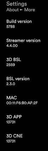

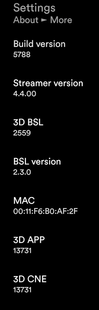

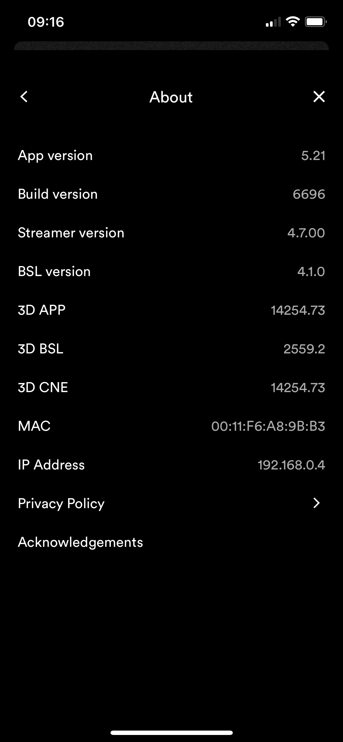

That isn’t telling you what I was meaning. Obviously the Android app is limited in what it does. Edit: ah I have realised that if I tap onto your photo and sign into Google then I can see more of the screen shot and it’s indeed showing the 3D SW. I will leave the rest of the post as it is in case it helps anyone else.
This is a screenshot from the IOS app on a SuperUniti, but it should be very similar in an NDX.
You can do also it with the remote control and the screen on the NDX. Basically press the spanner key, scroll down to Factory Settings and select it, select System Status and scroll down to BC SW: and hope that the value next to it starts with 3D.
