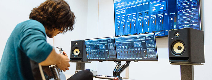

Nearfield is a term used in studio environments where the speakers function more like headphones, with the goal of hearing as much detail as possible. Nearfield speakers generally have a smaller angle of sound direction compared to hifi speakers.
This is as an example a nearfield listening setup:

Agreed here. I have Harbeth P3ESRs in my office and I listen to those in nearfield, for certain. You describe this setup perfectly.
