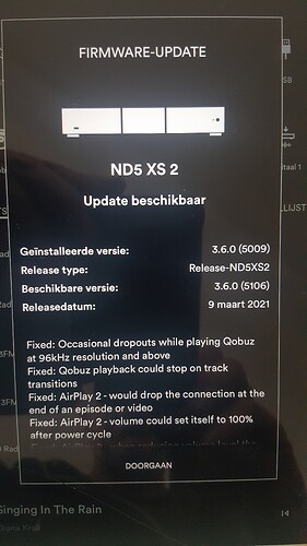

Hi all,
I upgraded from v 3.6.0 (5009) to 3.6.0 (5106).
Still great sound. Was the (5009) a beta (test)version? I’m not in the beta test group (yet).
I got it a couple of months ago from @Steve and it fixed my Qobuz ‘only playing one track and stop’ issue .
Regards
Gerben.
Yes
Thank you,
clear😊
