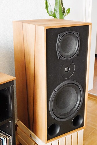

I recently finished building my custom speakers from Troel Gravens - Faital 3WC-10.
it was such a fun project to build my own custom speaker. Here is a picture for you:
The new speakers are ghe following:
Basics:
3-driver speaker
Dimensions: 37.5 x 40 x 68 cm, WxDxH.
System sensitivity: 93 dB/2.8V/1 meter.
Impedance: 8 Ohms, minimum 5 Ohms at 35 and 700 Hz.
Point of crossover: 500 and 2400 Hz, LR2 filter.
Power requirement: 20+ watts/channel.
I love the speakers, but would love to get some better quality music.

Thank you so much! Was an interesting journey building a speaker. I just like the “vintage” design…

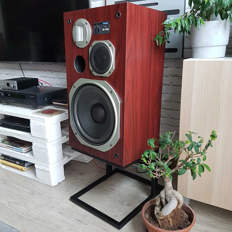

These stands look great. The only concers are, that they are to big for my room.
I can’t decide whether I should build something like this:

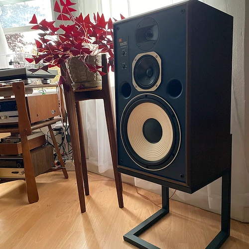

or this:

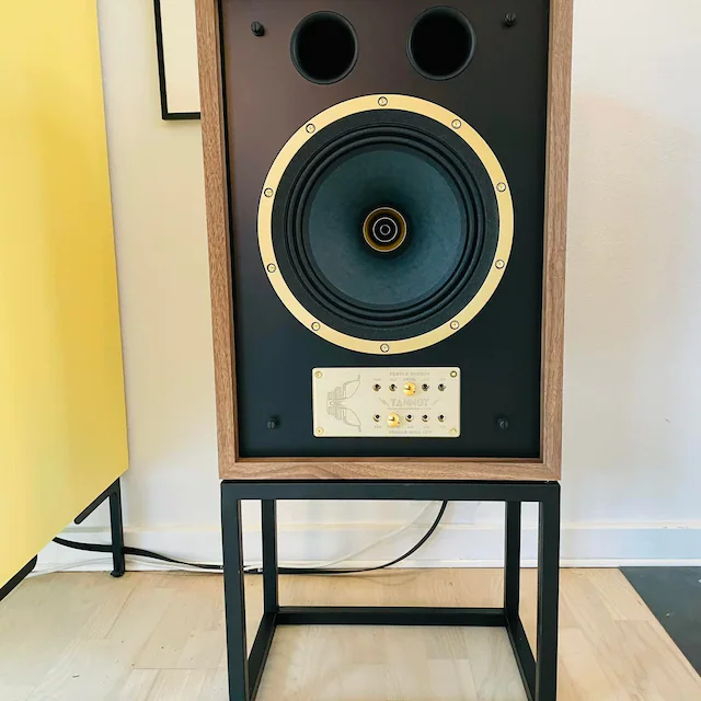

or this:

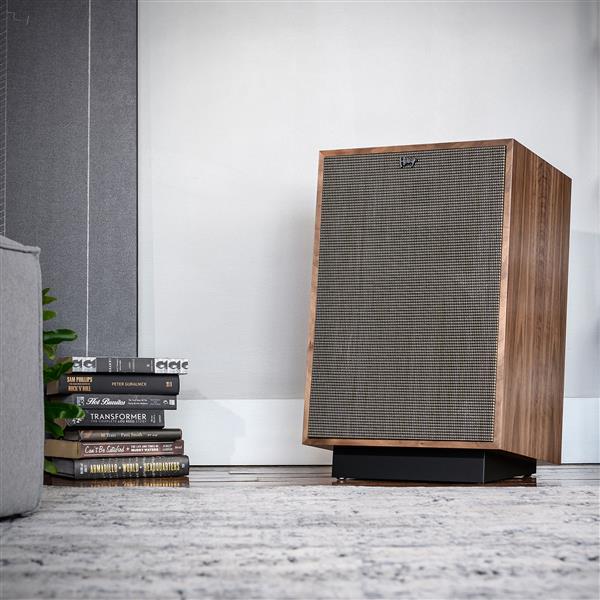

Or something like the klipsch heresy stands.. I know they are not ideal because of the alignment of the tweeter and bass.
It’s a hard decition… But for sure they won’t stay on those boxes.
