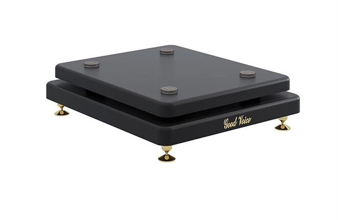

With a large heavy speaker you should avoid the first two stands, which are a cantilever design and will oscillate. You want four sturdy legs, such as the example in the third picture, with spikes to decouple from the floor and enable precise levelling.
Better is three legs or a flat plate with three spikes, three makes it wobble free.

Do you think something like this is a good match?
I also found some with wheels :slight_smile:
Or just 3 spikes underneath.

You want the tweeters at ear level to get the intended sound. You may want to take advice from Troels as to what he feels works best. There is a lot to speaker stands and they can make the speakers sound quite different. Some benefit from heavy stands with flat top plates, while others benefit from an open frame construction. In all cases the stands should be sturdy and not rock.
