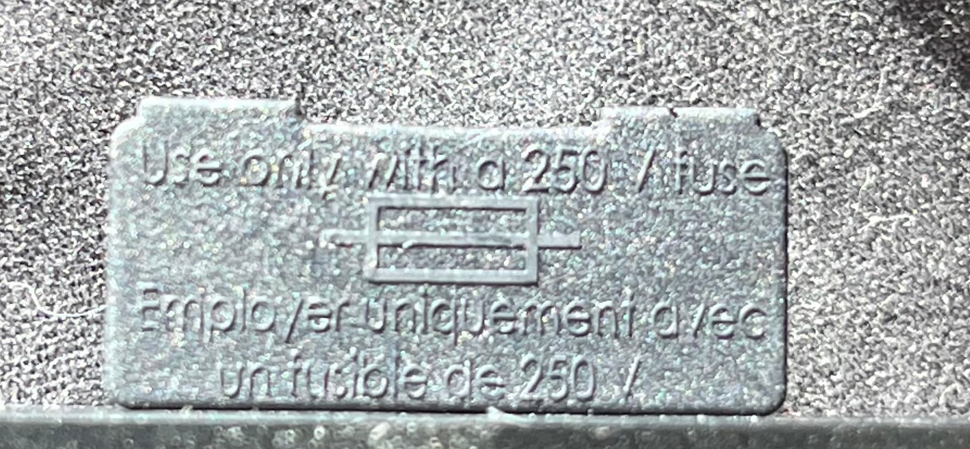

Yes, but be aware that it’s different whether 115V or 230V.
It came with a spare. The old fuse was blown.
If someone can post where to order spare fuses for the US, that would be helpful.
Looks like it’s working again.

This is pic of the cover.
Found this link but it’s a UK site. But if this is the right fuse, can just buy same type from Amazon. Have 10 pack for $8
I just looked on old fuse. it’s a T2AL250, so different than the UK link.
Yes, see my posts above. If 115V then it’s a different fuse.
The T2 bit is important. Basically it means it’s slow blow.
