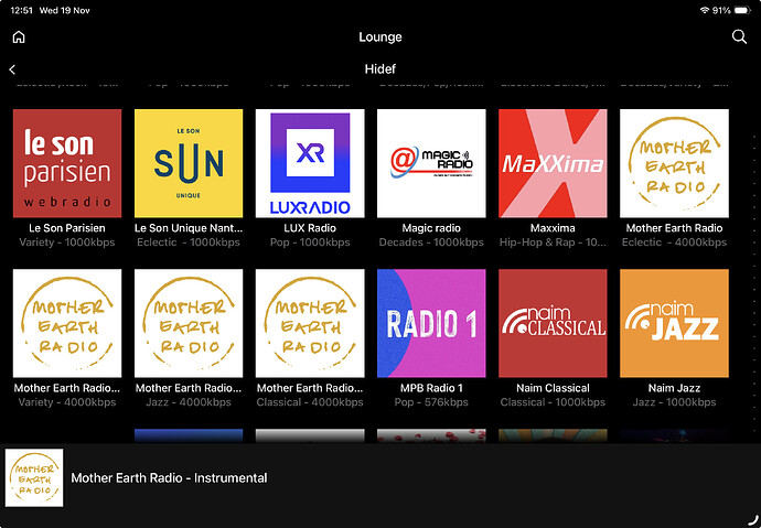

What happens when you select the Hidef web radio streams on the Naim app… it seems to play out fine with me at varying lossless resolutions upto 192/24 FLAC ie Mother Earth Radio.

try Mother Earth Radio.. its 192/24 FLAC

So what do you see for the four Mother Earth web radio stations. I see them at 192/24 FLAC in the hidef folder.
