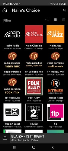

But I have a more general question, not that it is much of an issue. If I set stations in VTuner (and I do carefully observe all bits and pieces), they appear in “Added Stations” on the app, but I cannot stream anything. Means they do not play at all. Am I doing something wrong in VTuner or is it my Superuniti that is not compatible?
The same stations found via the app (e.g. Naim’s Choice) play nicely, though in 320 max. Again, not really a big problem, but why wouldn’t the app find FLAC-stations?
I don’t think the SuperUniti (nor any of the old streamers) supports flac iradio stations.
Thanks David. Radio is for background only, so not much of a big deal. I was wondering what the technical reason might be.
The short answer is that the old Naim streamers don’t support the slightly unusual format of OGG in a FLAC wrapper which lossless iRadio stations use.
