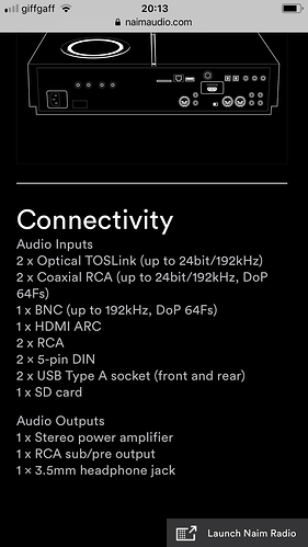

According to the blurb it has three analogue outputs, all of which are post volume control.

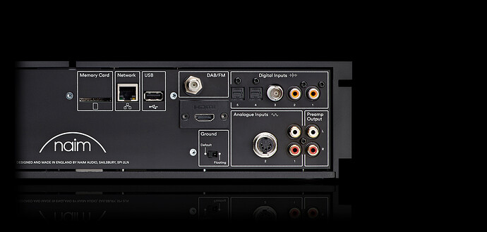

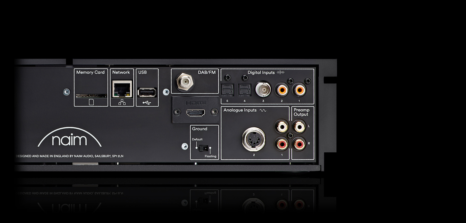

The Nova has just a pre-amp output. There are also 2 analogue inputs (In the area labelled Analogue Inputs), one on Din and one on RAC phono. I’m not sure what this section labelled “AV” is that you are seeing…
The little sine wave symbol after the analogue inputs text looks a bit like the letters A/V if you squint a bit…

That picture must be a star because my nova has more inputs and outputs are in a different spot.
Some early images of the Nova (during the long delay between announcement and actual release) showed different input/output sockets from those on units that were actually released, so I wonder if that is where the confusion lies?

What i meant was it looks like it says A/V but it’s actually a symbol of a Sine wave which is where you may be getting the idea that the output has AV related facilities.

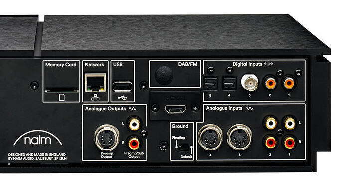

Ah yes, sorry the pic above was a Star. Here’s the rear of a Nova;
However, still there’s only Analogue Inputs and Analogue pre-amp outputs (on DIN and RCA); there’s no line output.
As for “AV”, as James mentions above, perhaps that’s what the sine wave is being mistaken for?

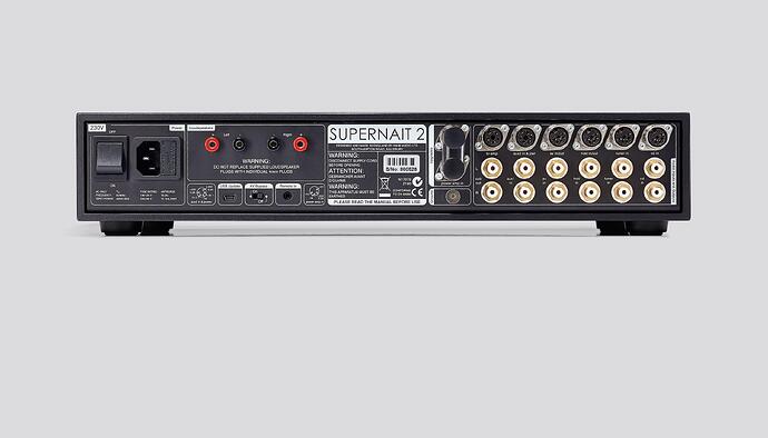

You could try running the Nova Pre-out into a Unity Gain set input of the Supernait 2. You would then be using the volume control of the Nova and effectively bypassing the Supernait’s pre-amp when set to the Nova’s input.
@Richard.Dane which input has the Unity Gain on the SN 2?
Hi,
use the AV In/out input and set “AV Bypass” to on.
Which device is that?
