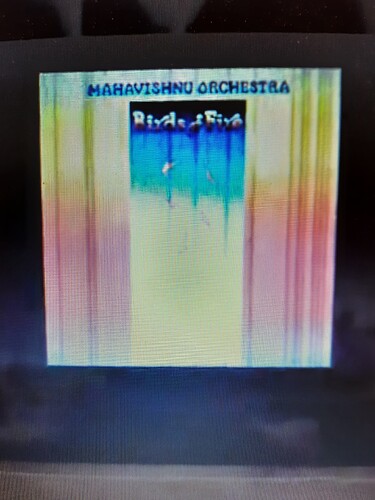

Breaking in my new Nova, loving it so far.
However, I noticed something earlier, which has caused a little concern.
When I put on an album, the artwork was intact, but had multiple flashing black lines through it, vertically. Almost like a bad TV reception.
The album was ‘662’, by Christone ‘Kingfish’ Ingram (checking it out as a Mojo recommendation). Didn’t get very far as the flashing was very distracting!
It hasn’t happened on any other album in the last few days since purchase, just this one so far.
I’m a bit worried as my previous Atom, it took until my third to get a good one. The second suffered red lines, diagonally, across the screen. Posted here about and returned it, replacement was fine.
Any thoughts/advice? It would happen today when everything closes for Christmas!
Happened in the first week of mine and my dealer swooped it for a new one, no problem since

My Nova had similar lines one or twice fixed by extended power off and restart - album art or onscreen graphics would show but became corrupted, sometimes with dynamic changes to the display rather than static - all very odd, not seen it in ages now. Might even be something that’s been addressed in firmware (I think screen display buffer refreshes have been reduced recently unless the display has actually changed).
It went away for a few days - but it’s back.
Different album, of which I started yesterday, and was continuing this evening. Soon as it came on, it was going bananas.

Hope this works better -
All the lines move around like TV interference. Have tried the reset stuff the other day when it first occurred - fine for a few days, then back with a vengence!

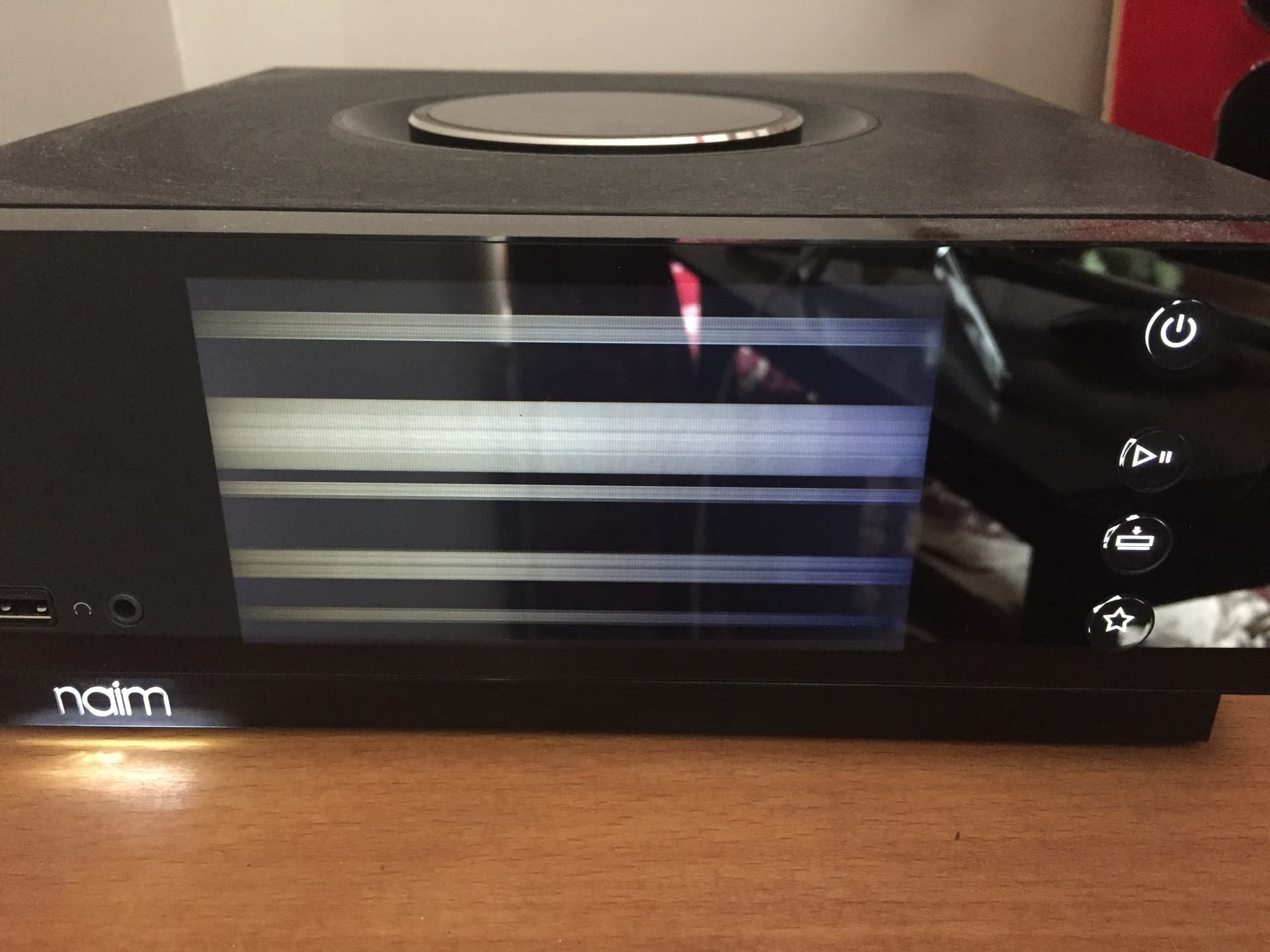

Most of the glitches I’ve seen have been horizontal rather than vertical similar to ChrisSU’s post above or that sort of effect corrupting artwork.
I have had corruption that changes with time too which has not reappeared in absolutely ages - an image would display and gradually get corrupted in an odd manner - I’ve assumed disconnecting for an extended period resets some display circuitry issues, but why they happen in the first place is a mystery.
If it keeps happening it’s not right and should be exchanged.

I’ll take your advice and chat to the dealer tomorrow. Thought it was fixed, as it had been alright for the last few days. Changed record earlier, and it’s fine once more.
Annoying really, as I wish it would just stay like it, as intermittent problems are the worst. I have managed to get the photo, and a 10 second video which I can forward to them as proof.
