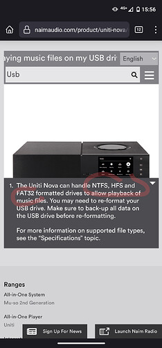

Is the Nova support page wrong? Says FAT32, NTFS, or HFS
Fat32 works with all Naim streamers, if you are looking for cross compatibility.
Ok, but the OP has a Nova. I guess that it should work with NTFS. But of course reformatting is a good way to rule out certain issues
