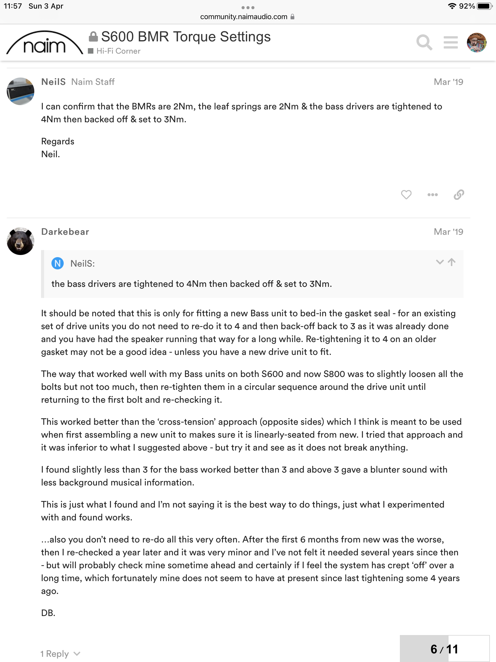

By components I meant the measurements (Nm) equal to the screws to be tightened. Thanks
Some more here…
