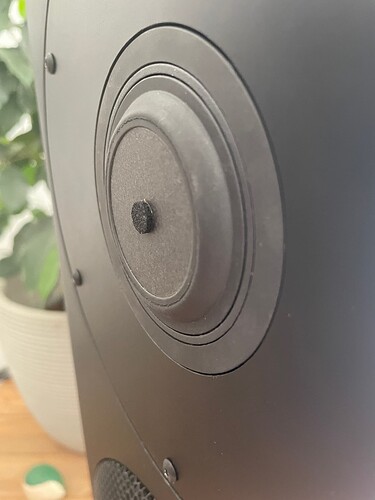

I am hoping someone who knows something about speakers can tell what the technical problem is with the BMR. I am placing a picture of the front. I hope this may help looking for someone with the right experience and tools in the hope they can be fixed.
Like I said in my first post I can push at the front in the center. There is a magnetic like resistance because I here no sound (scratching from windings to the magnet). The voice coil shouldn’t be magnetic and if the coil is charged then it would loose that charge when I unplug the speaker eventually. The speaker has been unplugged for 2 days with no difference to the resistance.
Would love to here some ideas.
You may want to reach out to Karl Heinz Fink, he is the designer of the Ovator series. You may be lucky and get a response / suggestion.
