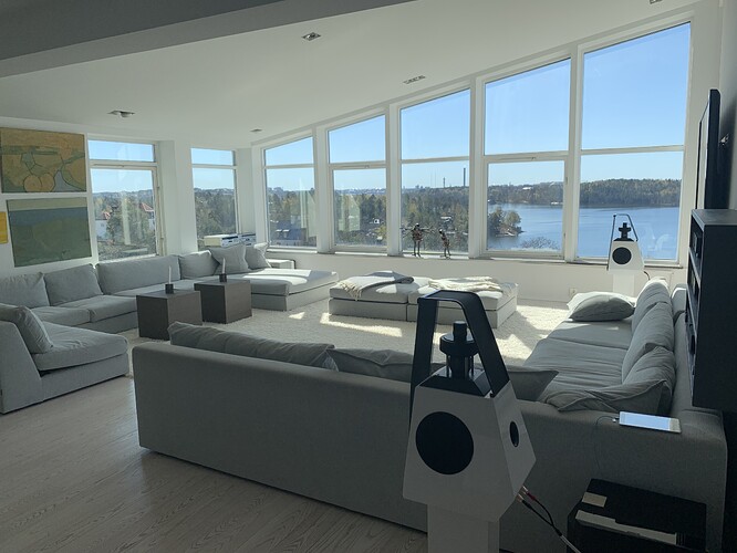

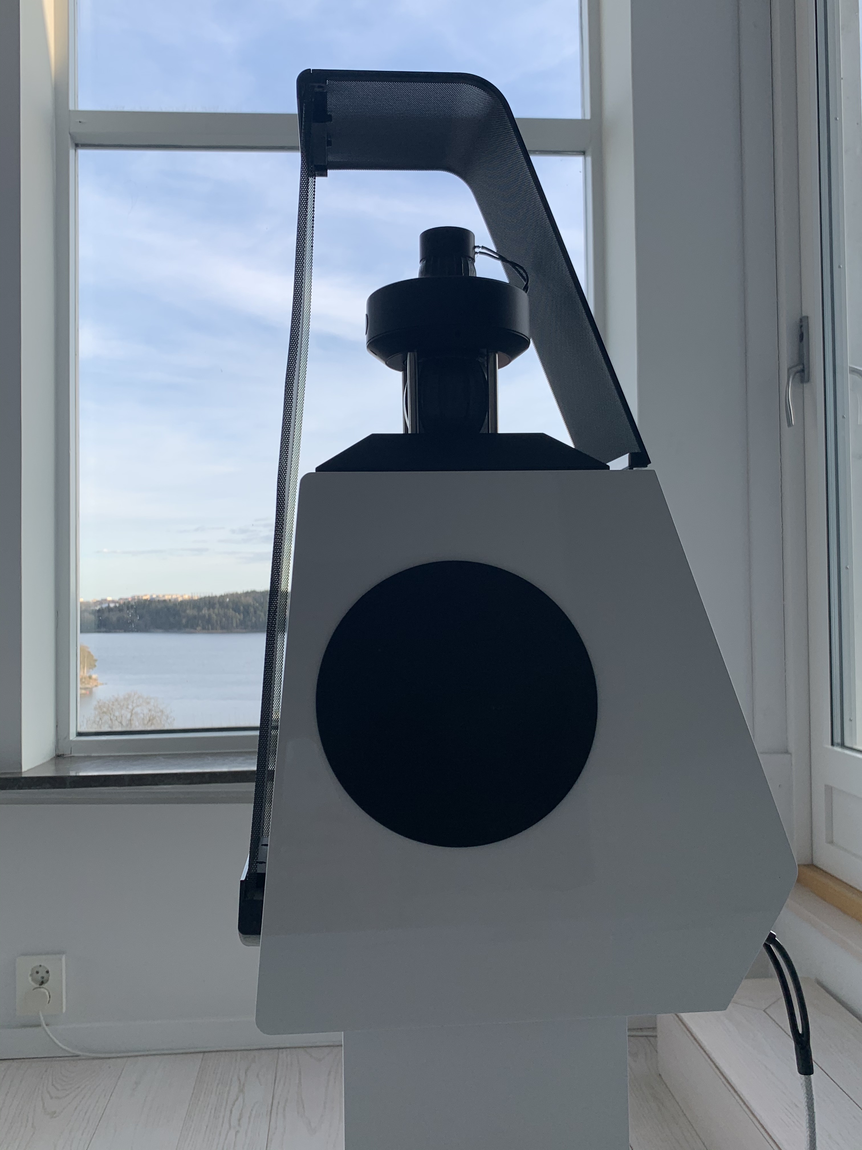

I have an NDX 2/XPS DR, Supernait 3/HiCap and my 8 year old MBL 126 omnidirectional speakers supported by a small Focal sub. The rooms is quite large and the distribution of the MBL’s is wonderful. However, they are quite small and hard to drive and don’t really sound relaxed enough.

I’m not sure what system you built with your MBL’s in mind but they will likely be better off being sold and replaced by something more suitable to the rest of your current system.

I’d expect the speaker placement in that open plan setting will be challenging and difficult to get a nice soundstage and stereo imaging, hence my suggestion to look at some bigger box options!

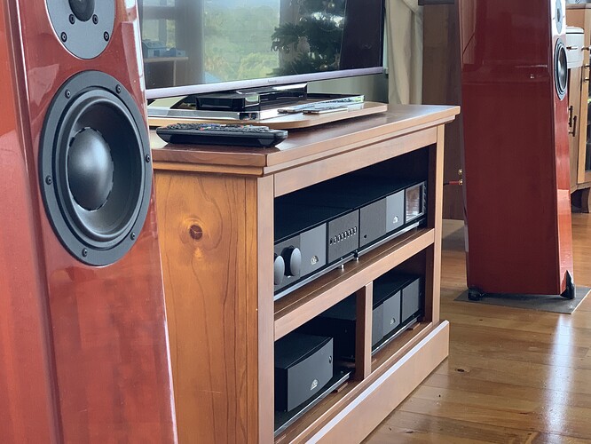

That’s a delightful space and lovely looking speakers. I have a similar room and the same system (expect SN2 not SN3) and I use Totem Forest Signatures, which match very well:

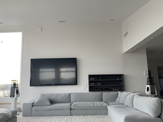

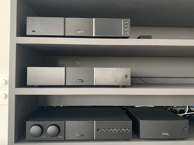

the Hicap is a bit too close to the Supernait, the first thing I would do is move them apart
lovely room and view, but maybe you need to think of some kind of hi-fi rack. Hope the various cables like Burndy and SNAIC between Hicap and SN are properly destressed and cable dressing is optimal. Are the power cables going into sockets directly or through some kind of mains extension, if so, hope it has no neon lights or surge protection.
These things do matter with Naim as the amps are revealing and will tell you if something is not right.

Wow, what a stunning room! I’m green with envy.
However, speaker placement and choice may be tricky. Is there any chance of moving the furniture? Or moving the position of the speakers? The right speaker (facing them) is firing over one of the sofas, which I suspect means a stand-mount on a reasonably high stand. The speakers are also a long way apart and asymmetrical, which could lead to a hole in the middle of your soundstage. I agree with others suggesting adding one or even two subwoofers, but it can be tricky getting them to integrate with the main speakers. However, this may be the only option if the speakers and furniture have to remain in the same position. ATCs were mentioned, but I’d try 19s rather than 11s if you can get them high enough.
If you could arrange things so the sound from the speakers is not interrupted, full range floor standers might work, but they would need to be efficient. If price were no object, I’d suggest some of the larger active ATCs, in white, and swapping the SN for a preamp. But that’s serious money. You could even drive them from a Linn DSM and use Linn’s space optimisation to correct for the room shape and materials.
