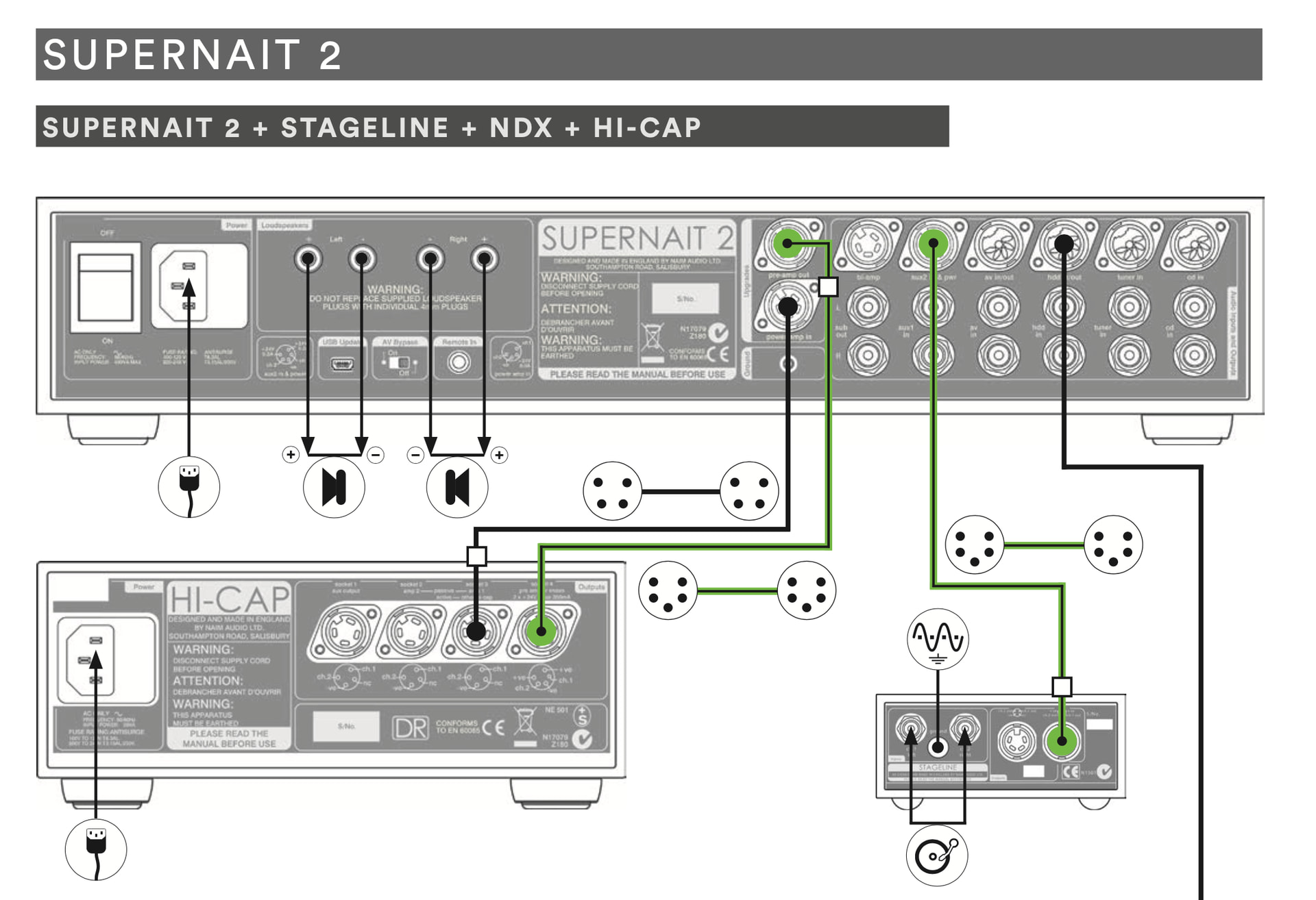

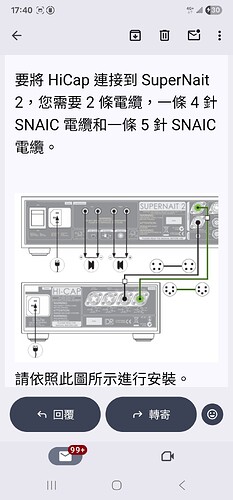

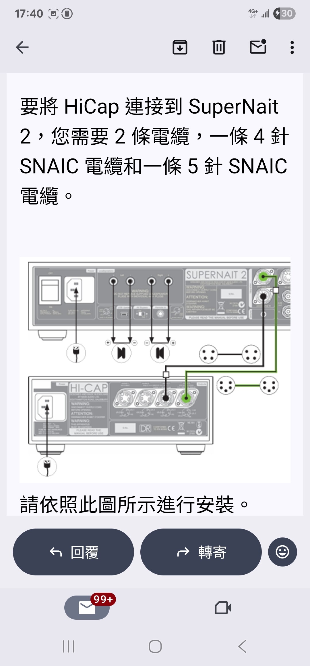

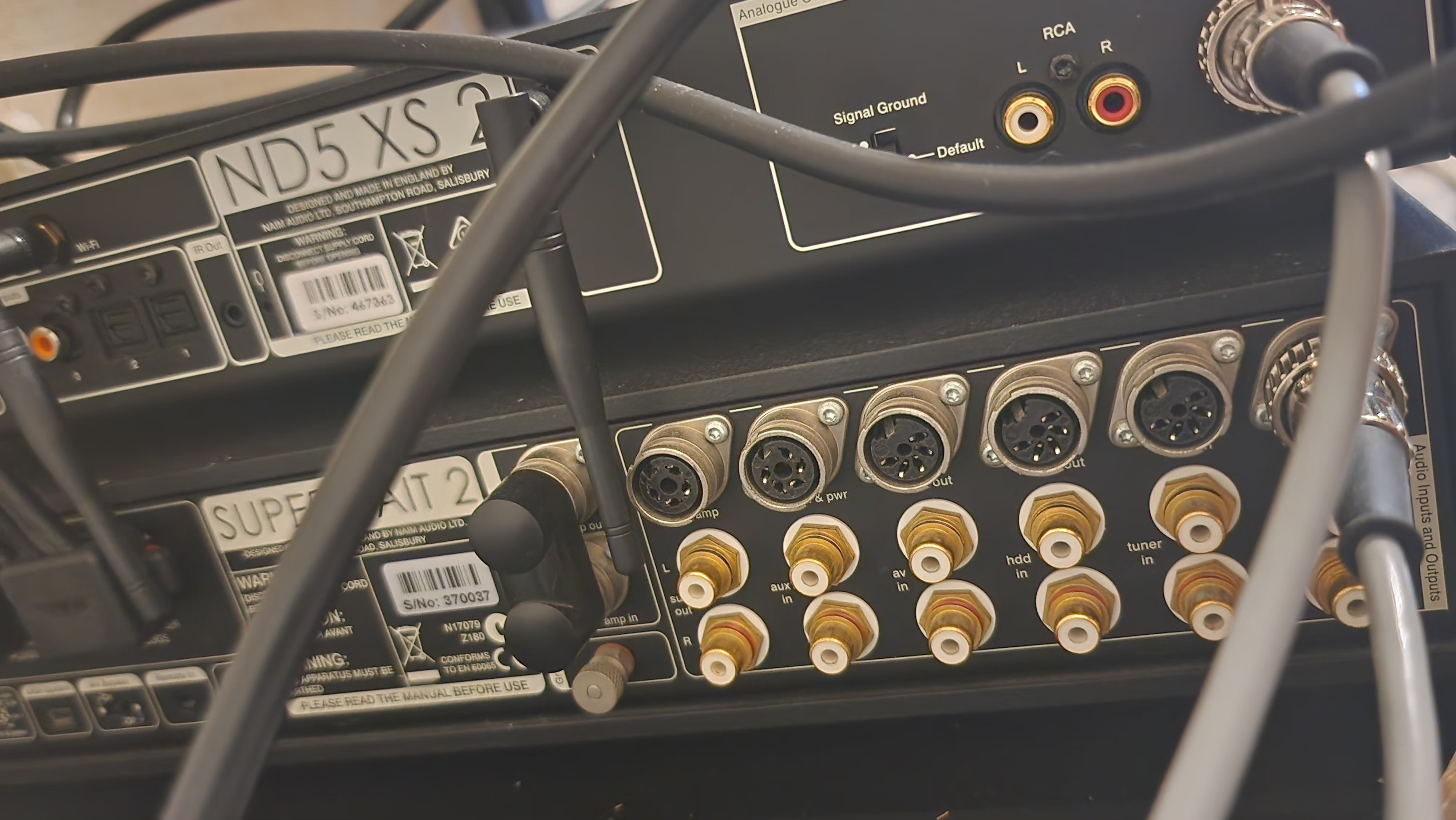

Please ask my supernait 2 back is different
Please ask my supernait 2 back and your official teaching image backhole position are different.:grinning_face:
Should supernait 2 to hicapdr how to connect
Hi, you will need to switch off the Supernait, and disconnect the large link plug connecting the Pre-amp OUT and Power-amp IN sockets. Then you connect the HICAP via the supplied SNAIC5 and an additional SNAIC4. The SNAIC5 provides 2 x 24V DC power to the pre-amp of the Supernait and also takes the pre-map audio signal into the HICAP. Signal is then taken out of the HICAP into the power-amp section of the Supernait via the SNAIC4. Be sure that the banded ends are correctly orientated (always at source of music signal).

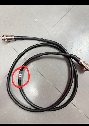

I found sellers online with two different color labels of cable material snaic 4, which are white and green, and both are black versions. What are the differences
Naim supernait 2 with Hicapdr

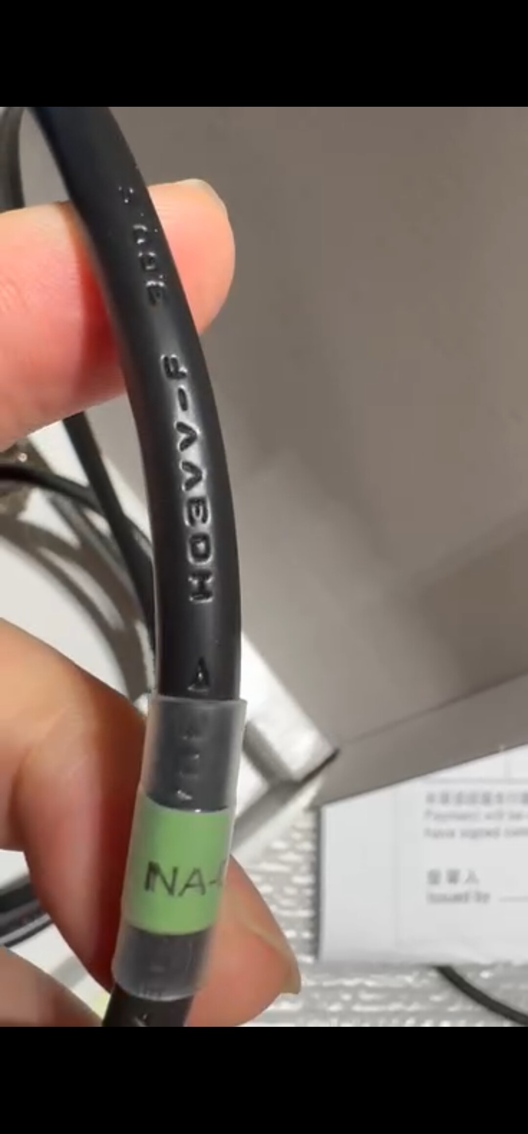

A green band usually indicates a SNAIC5, a white band a SNAIC4. Do be sure that any SNAICs are genuine Naim items. See the FAQ link I posted above.
Hello Charlie, I have read the reply from the management above. I would like to ask if two pieces of wire are also naim snaic 4 holes, and with a pen around the middle of the wire, there are two different white and green labels, which represent new and old technologies

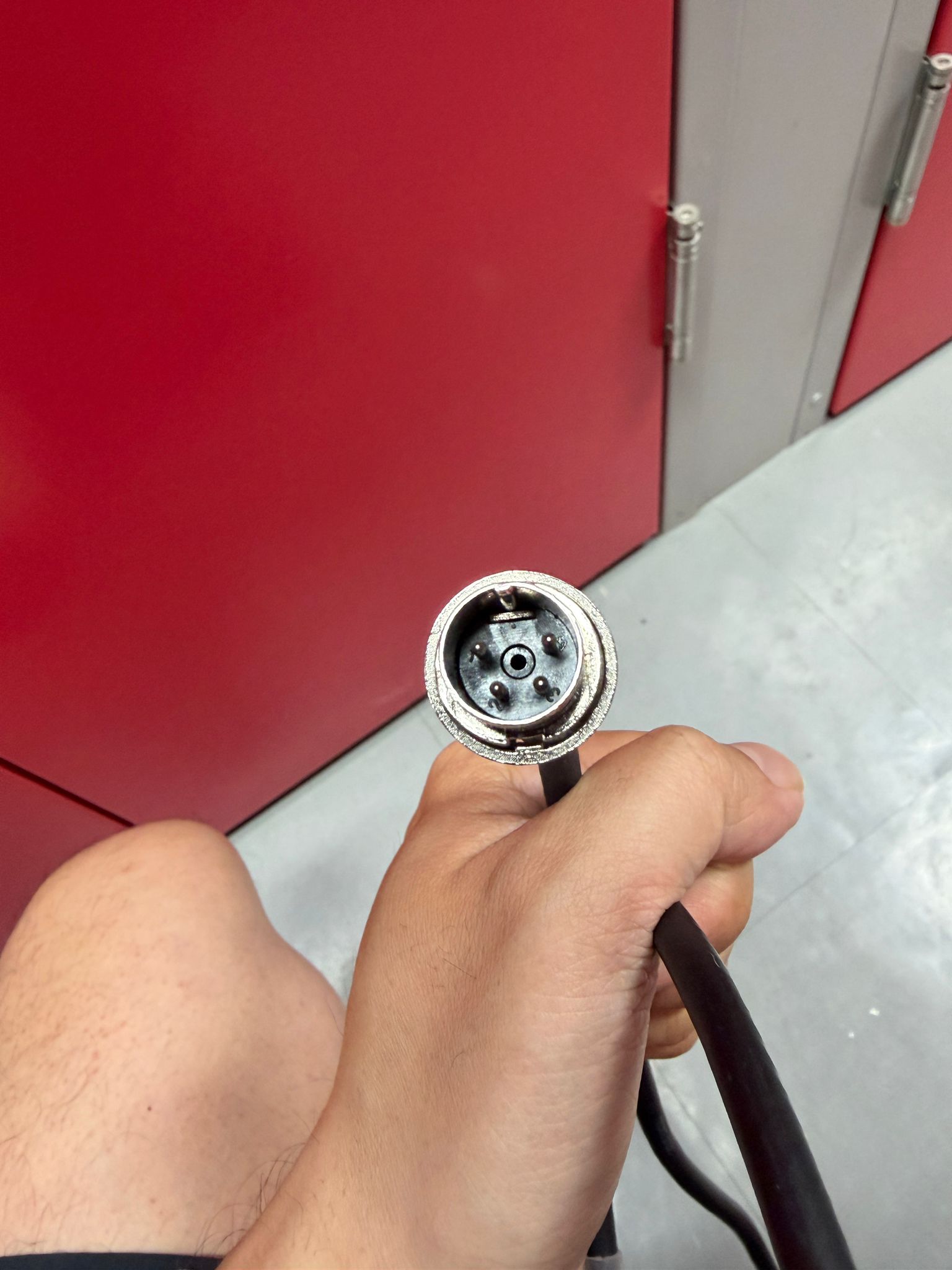

Can you see the place where I used the circle, because my English is translated through translation, maybe I’m not clear. The picture shows two sellers, and the tape at the center of the cable material is white and green, because they are all snaic4. I don’t know which one to choose
:blush: thank
The white banded one is definitely a SNAIC4 and I can see the Naim logo on the sheathing, so looks genuine.
The green banded one is less easy to distinguish as it doesn’t show the whole cable or ends.
The green one
The green one
All right, Charlie has given you the green picture ,Assuming both are original, is there a difference between the red and white sounds,for supernait 2
Thanks, OK that looks like a 4-4 active lead. It is possible to use it here in place of the SNAIC4, but the SNAIC4 is what is specified by Naim so I would use that.
